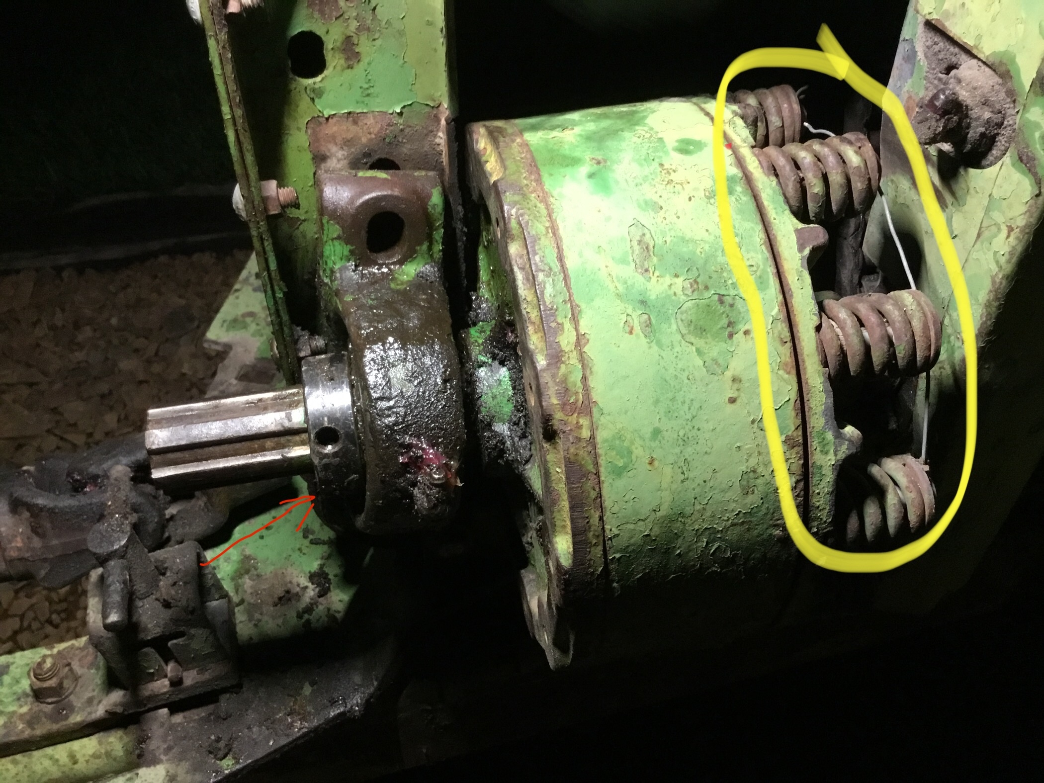

Lost my overrunning/slip clutch tonight on my old 14T, can’t figure out how to get this collar off so I can remove the clutch and open it up to figure out what broke. I can hear something metal clanking around inside. Is this collar pressed on? I removed the set screw but it won’t budge.

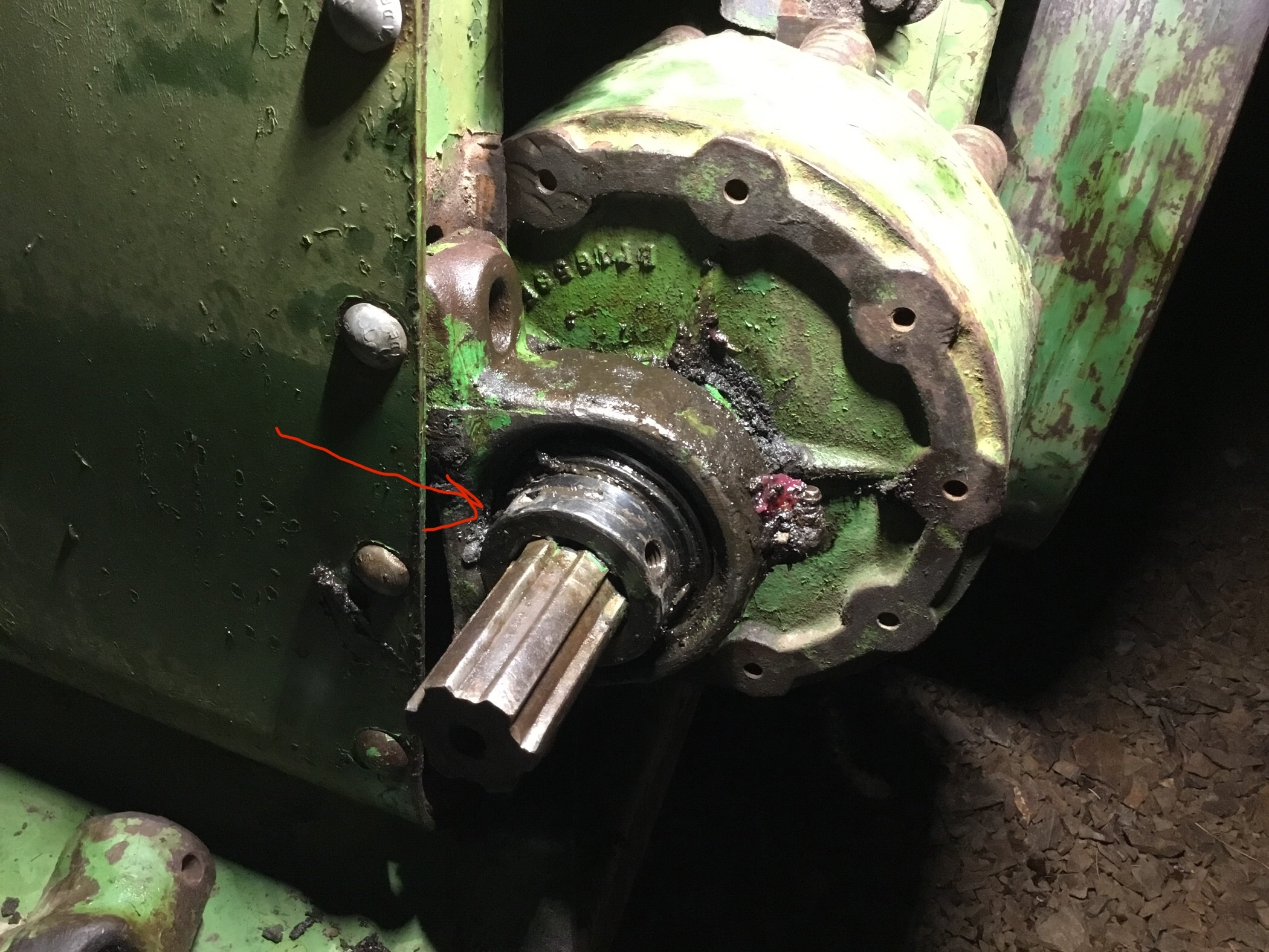

Another picture from a different angle

Yes, it's very much like that one.
   / 14T baler overrunning/slip clutch removal #5
Locking collar needs to be rotated on brg inner race using a punch & hammer to free brg inner race from shaft

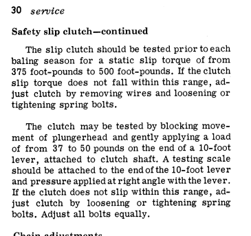

I’ve got another question, I’m obviously going to need to open up the clutch housing and end up having to remove the 10 slip clutch bolts, I checked with my local JD shop this afternoon to get the torque setting for when I re-install them… they couldn’t find the specs for them. Does anyone know what it is?
   / 14T baler overrunning/slip clutch removal #7
Information in photo below was copied from 14T operators manual concerning adjusting main drive slip clutch.

Got it! So no actual torque setting for the bolts themselves, instead… tighten and test the torque on the actual drive system until it breaks in the correct # range… sounds simple enough. Thanks again, really appreciate the help with this!
