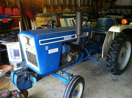

I just purchased a 1500. It doesn't have a overflow tank for the radiator and I don't think it has ever had one. When I fill the radiator up completely it puts coolant out the the overflow for a short period and then stops. Should I add a tank or not? ford 1500.jpg

Well I'm responding to my own post. I thought there would be a 1500 owner respond and at least tell me if a 1500 has an overflow tank or If I should add one. This tractor is all original with the overflow tube is running beside the radiator all the way to the bottom.

I don't think they had a tank, but you can check the parts lists and diagrams here: New Holland Parts | Messick's
Thanks for the reply. The parts list doesn't show a tank so I suppose It will put coolant out till it has enough room in the radiator for expansion.
   / 1500 Radiator Overflow Tank #5
We had a Ford 1100. It didn't have a coolant recovery tank. It just belched out the extra through the tube onto the ground until there was enough room in the radiator.
