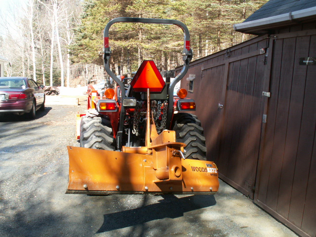

I have a new 1520 that replaced my older 90's vintage 1520. Basically the same tractor with more HP. My problem is, my old tractor had a nice little factory tool box that was mounted right behind the seat. My dealer was not able to get me that same box, but ordered a new plastic box that simply does not fit. Has anyone made , or retrofitted a box on one of these tractors? One of the problems is that I am 6' 3" tall, and must have the seat all the way back, which leaves very little space between the seat, and the lift arms for the 3PH. I was thinking about making a bracket that would span the two ROPS uprights, but I'm not sure exactly how to do that. Any suggestions?
   / 1520 tool box #2
I attach piece angle iron between the rops,welded plate on angel iron than bolted ammo box,doesn't affect 3pt hitch...seat all the way back easy to get to box.
