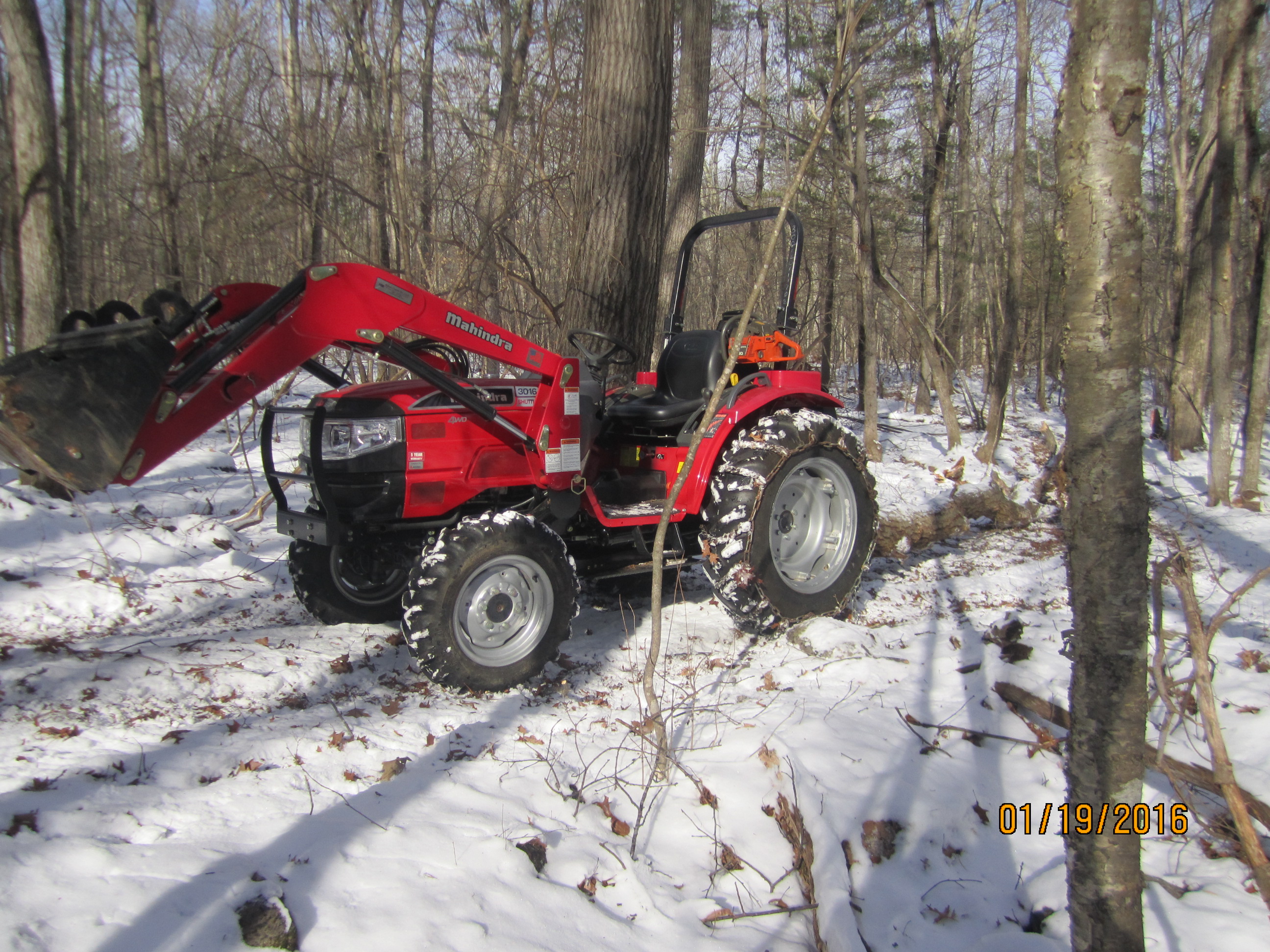

My 3016 (same tractor as yours with a different #) crawled to a stop right where you see it. Just slowly conked out as if it ran out of fuel. I went back to the barn and got a screw driver and used this to bleed the bowl. I also took off the hose leading to the injectors and blew through that and bled some more at this point. Fuel bowl filled up, tractor breathed to life and off we went. I have no idea what caused this whether it was the cold, the hill and the load or a fuel feed problem such as a vapor bubble. This was the only time it did this and acted much as you describe your's is doing.
I bought one of those fine mesh funnels (not the expensive Mr. Funnel) and always use that during fill ups and still had the same trouble as described so I do not think it's crap in the filter.
