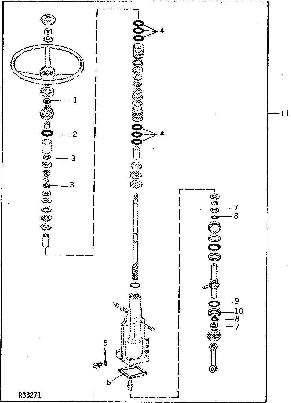

i have a john deere 1530 with a loader that all of a sudden started get hard to steer to the left and then started leaking fluid from the steering colunm and the base of the steering box. I stopped moving dirt and parked it. havent pulled off the sheet metal yet but will do it tomorrow. What am I going to be loooking at and what would probably be the parts i will be replacing. ive worked on truck powerr steering gears but not a tractor, havent realy had tkis one long. any help would be appreciated.

Sorry but the PS supply line is on RH(passengers)side.
More than likely the leak cure will be installing this kit(AT315816 KIT, OVERHAUL ADD 70.75 USD) which can be accomplishing by removing steering shaft with valves attached without needing to remove steering valve housing from tractor.
Hard steering in one or both directions could be simply a failed o-ring(parts key #4) or this valve(AR81610 BODY STEERING VALVE ASSEMBLY ADD 251.51)

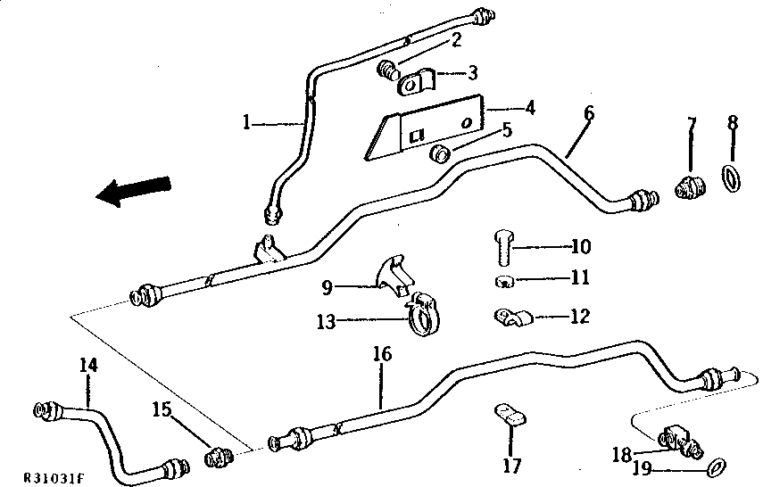

Zebrafive
Technically the PS line attaches to a line leading from main hyd to the priority valve. PS line is parts key # 1 and supply line is parts key # 6. The only special tools required are a spanner wrench and a long pick to R&R the 6 larger o-rings. I've used a pipe wrench or large slip joint pliers in lieu of spanner wrench

I went out and took a better look at it after pulling the sheet metal and to find out what I could see. I looked in the bottom ,didnt see any lines broken or leaking, it was leaking out of the colunm,around the base and coming out the top of the colunm.
it appears to be fairly straight forward once I can figure out the procedure. does the whole assembly come out as a unit or does the housing slip off of the shaft? it doesnt appear that the steering colunm has been off in a while I

You can remove steering wheel,then large adjusting nut,set steering wheel back on shaft and turn steering wheel to the left and the shaft and valves will come out the top of housing. No need to remove housing to change the 6 big o-rings.
