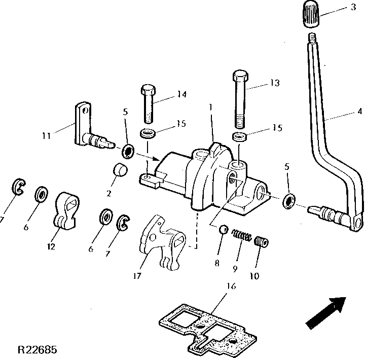

Hello, I have a 1530 and the pto shaft can be turned by hand while engaged (engine off). It has the manual engagement lever on the left side that works to engage and disengage. Disengaged the shaft turns freely as it should. Move the lever forward and the shaft engages and there is tension but the shaft can still be turned by hand. Pushing the clutch pedal all the way down has no effect on the effort required to turn the shaft. I do have the pto clutch lock out arm flipped out of the way so the clutch pedal should disengage the PTO shaft. I looked through the access hole and see the three levers with double lock nuts on the adjustment rods. What is the proper pto clutch adjustment procedure. Or is it trial and error? I see no place to take measurements with everything together.

I presume your tractor doesn't have the option of hyd ind pto with a control lever between gear shift levers? The only correct way to adjust the PP operating levers is with tractor split using the correct gauge.

I "assumed" that since I had a lever on the side for manual engagement of a sliding collar over splines that I did not have an independent PTO with a hydraulic clutch pack. There is a lever between the shift levers that moves up and down also. I reviewed the JD parts catalog and thought this would be a hi-lo lever. New unit to me and was purchased at estate sale with no known history. No operators manual. So the clutch pp levers have a height setting with a factory gage. One thing I did notice that the throwout bearing contacts each of the three fingers seperately instead of all at once. I have not noticed any clutch issues while driving and appears to pull strong. Only the PTO issue seems wrong. If it does have a PTO clutch pack it must be accessable at the mid split flange. I have the lift cover off due to leak at the flange. I am able to view the PTO engagement collar and lever.

Lever(parts key #4) is to control hyd ind pto. Both type pto's have control lever by left heel when sitting in the seat. Hyd pto can be engaged/disengaged on the go without depressing foot clutch pedal.
