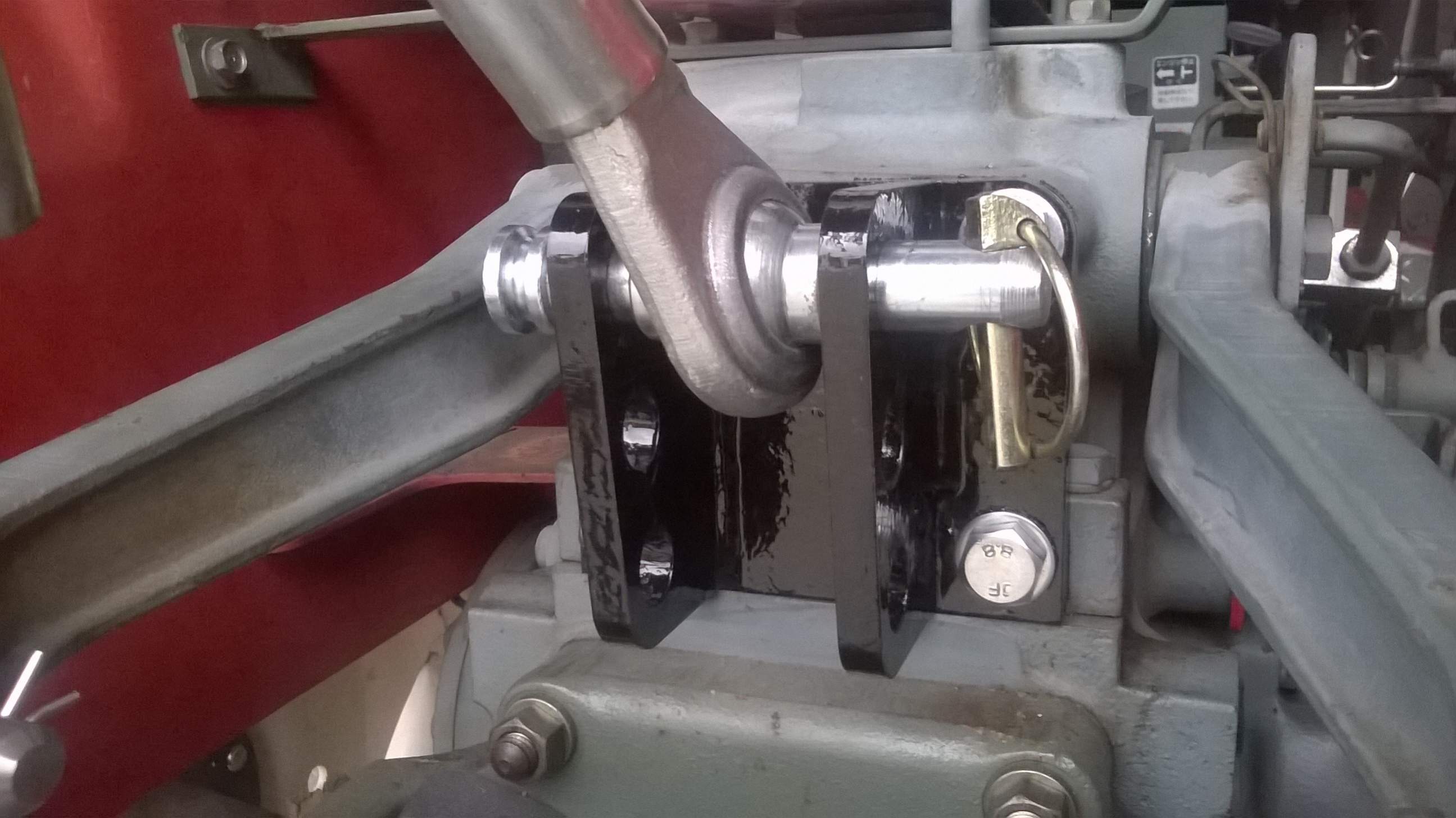

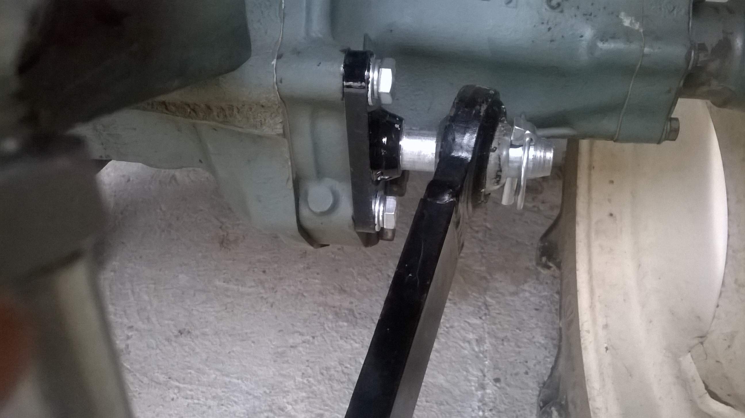

i'm Gianluca from Italy, this is my yanmar 1602d with new support for three poin, what do you think?

Gianluca - greetings & welcome to TBN!
Very nice! They look like factory made - did you fabricate them?
My only suggestion is to maybe add a bushing on each of the lower pins to prevent the arms from sliding left or right.
This would give you more stable support of your implement.
If you locate the bushing between the Heim fitting and the lynch pin, it will also reduce bending load on the pins.

Thanks for reply Jim, yes i drawn this pieces and cut by the laser machine! the lower pin is welded to the plate thickness 10mm and is inside the tractor case about 15mm, with this sistem i lift 250kg without any bend!! i agrre with you about the bushing to reduce the play :thumbsup:

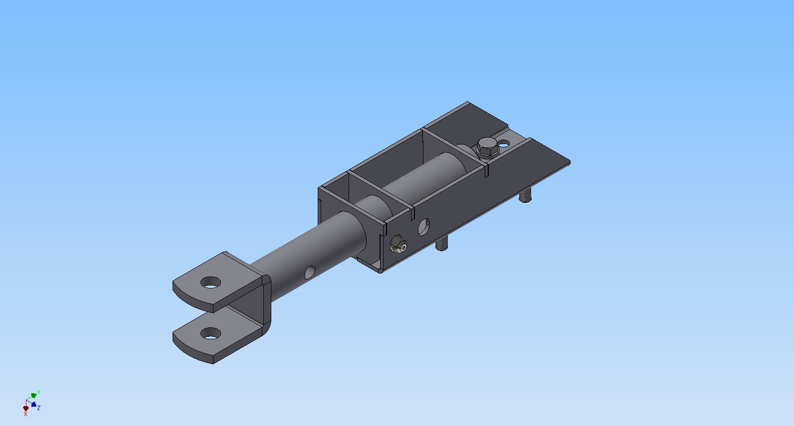

new drawbar telescopic!
