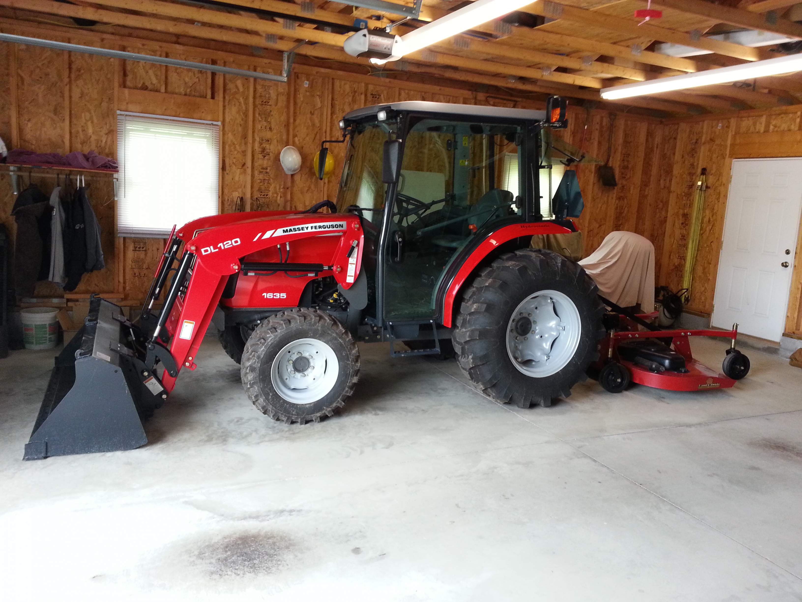

Really like the idea of a Power Shuttle. I have run heavy equipment most of my adult life and have yet to run into a hydro but most every backhoe and skip loader made has a power shuttle. The Case 580Super L i used to run had north of 9,000 hours on it and NEVER once had a transmission issue. My problem with hydro's are mostly in mowing. Here in the mountains we mow some steep stuff on occasion and every hyro i have ever tried has fallen flat on it's face bush hogging when you come to a hill where you end up at a snails pace where a gear drive will power right up the hill without slowing down. I agree with the poster above talking about the whine too. It can get annoying. The other thing i don't like on a hydro is no foot throttle for loader work. Just tooling around there is no reason to run a tractor at rated RPM but when you want to lift that bucket load of dirt to dump in the trailer on a hydro, you have to use the hand throttle. A Power Shuttle and Regular Shuttle have a foot throttle for this purpose. It seems as though Massey and Mahindra are the only ones in the under 50HP line with a power shuttle or did i miss one?
