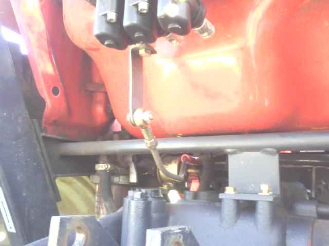

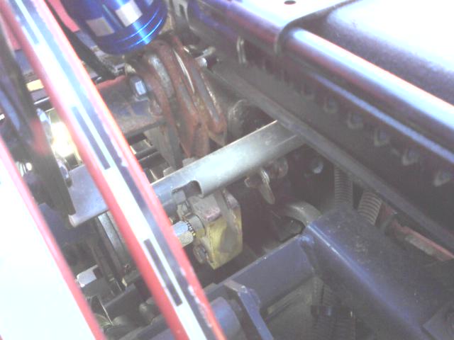

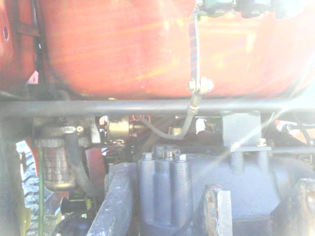

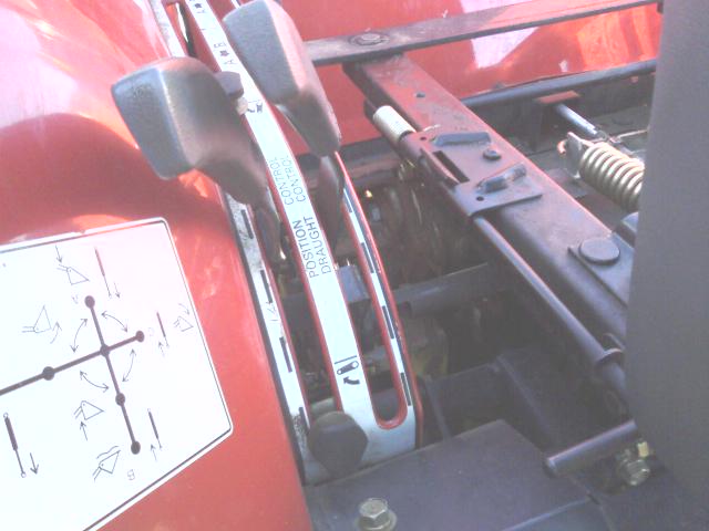

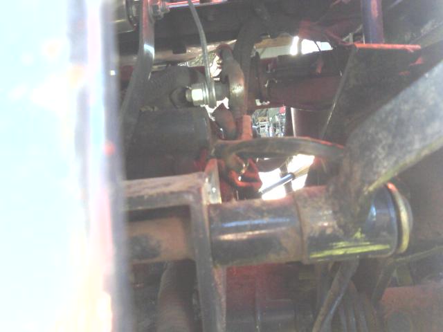

Boria, Here are a few pics of the one lever that I added and the linkage to the valve.Pics 4 and 5 are linkage to valve at the back of the tractor. Pic 3 the lever on the right is the one I added, it is attached to the pipe that runs to the other side and is on a pivot. 2 is the pipe running under the seat. Pic 1 is the tab on the other end of the pipe that is attached to the rod that runs back to the valve. Hope that helps.
