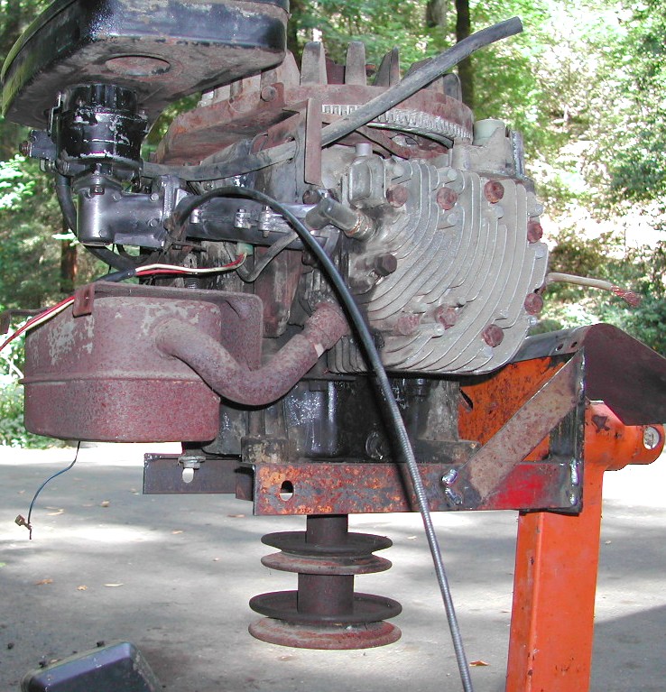

Yours is nice and clean and much newer than mine. Here is my 1979
vintage B&S 16 hp twin. It sat for years in a field, but once I took off
the carb and cleaned it up, it starts right up. My sheet metal is
removed for this photo, but you can see the carb and manifold. The
tractor it was attached to was a Craftsman. Mine is a vertical shaft
and yours seems to be horizontal. My carb has a nice brass float and
easy-access jets.

It looks as if you may have to pull the front end hood section off to get to the carb completely. I have an older JC Penney model and I had to do that to get to it easy. It has the 18 hp engine. It has no main jet adjustment on it. ie. the main jet is fixed and not adjustable, which sucks. It does have an air mixture screw and a idle screw. zman

IIRC the high speed jet is accessable without removing the carb or disassembling. There should be a hex head plug on the side of the carb toward the botom, a 1/2 or 9/16". I think the jet is inside the hole the plug is covering.
The carb top gasket must be in good condition as there are passages through it. Also it should have the fuel pump on the carb operated by crankcase pressure/vaccum.
