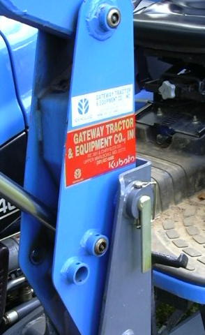

Attached is a picture of the upright/lift cylinder connection. As you can see, there are 2 holes: one used and the other empty. I have gone over the loader manual and it doesn't explicitly state why 2 holes exist. However, drawings seem to indicate the the upper hole is for the 16LA and the lower is for the 17LA. Has anyone with a 16LA moved the cylinder to the lower hole? My logic /forums/images/graemlins/shocked.gif says this rearrangement would give a little more height at the expense of digging depth. Conversely, has anyone with a 17LA changed holes?

This hole will change your digging depth about 2" give or take a little.
