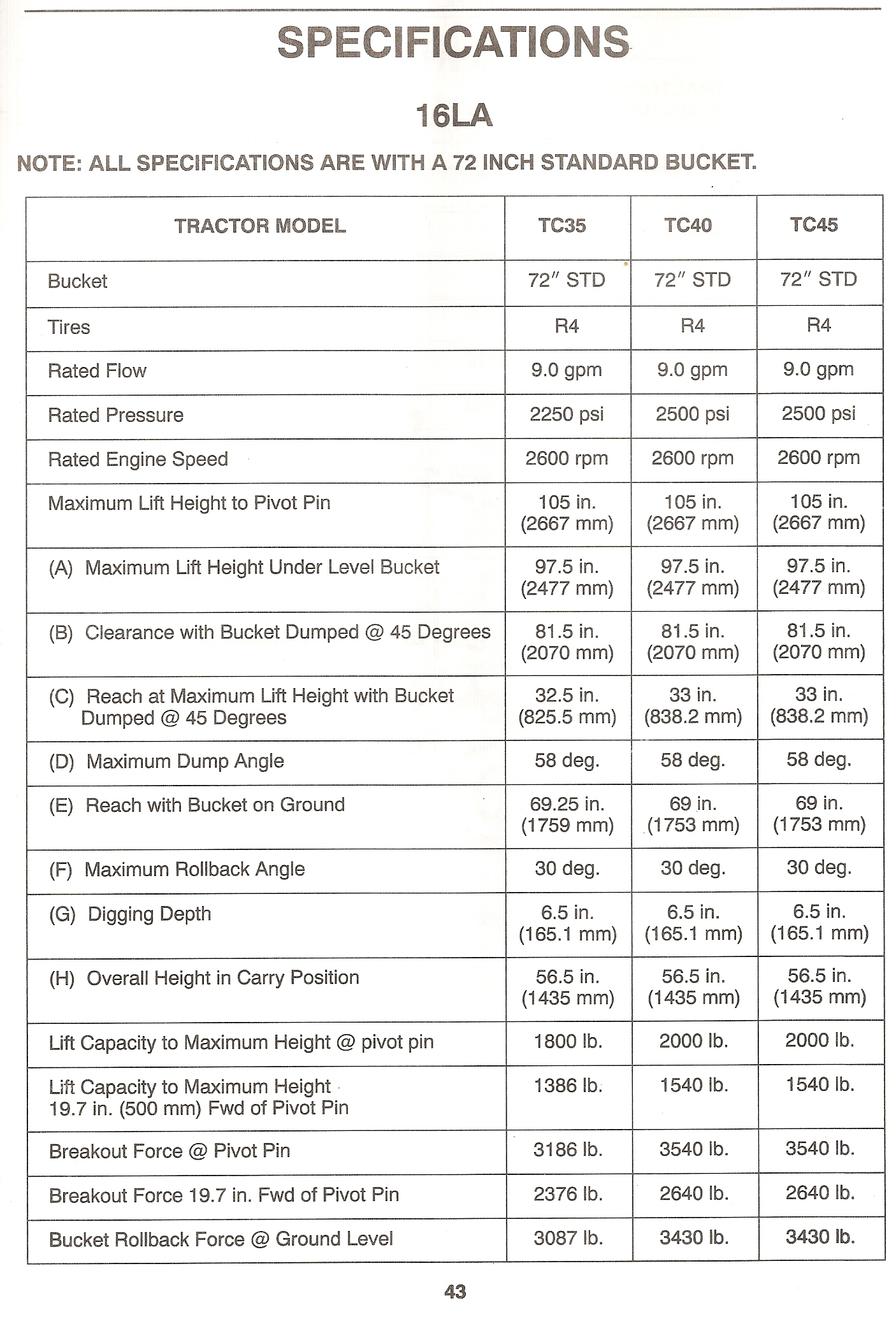

anyone got the #'s on what a 16la loader can do ( attached to say.. a tc40 type machine ).

I found a full height capacity of 1,300 -1,800 lbs. Depending on where it is measured. Tractordata TC35.

Here's some more info for you Soundguy
