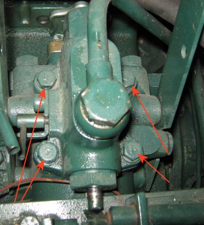

I have same tractor, and had same problem, using the same implement ( disc harrow ) what a coincident;) I had to remove the valve and install new O-rings inside, this will most likely correct your dads as well, Note: I'm not sure how to go about bleeding off the pressure before removing the valve, but be sure to have a way to rest the harrows on something like a set of jack stands, you can then remove the pins from both draw bars that attach upper and lower arms together, to safely remove the valve, I'll try and dig up the photo I have of the part that needs new O-rings,
   / 1700 Lift arms stuck in the up position #6
For now all I could find is the valve housing and the 4 bolts that need to be removed, along with the large Banjo bolt on top,
this is what you'll need to remove in order to get to the plunger inside that has the O-rings, I think I see in the illustration winston1 provided above the 2 O-rings I'm referring to, But while having it apart also be sure to inspect the smaller pc. inside the plunger/piston, there is a spring be careful not to loose this,
Oh! and I happen to think that if you let the tractor set a few hours or over night the lift may drop to the ground on its own, would certainly be much safer to work on with no risk of incident,

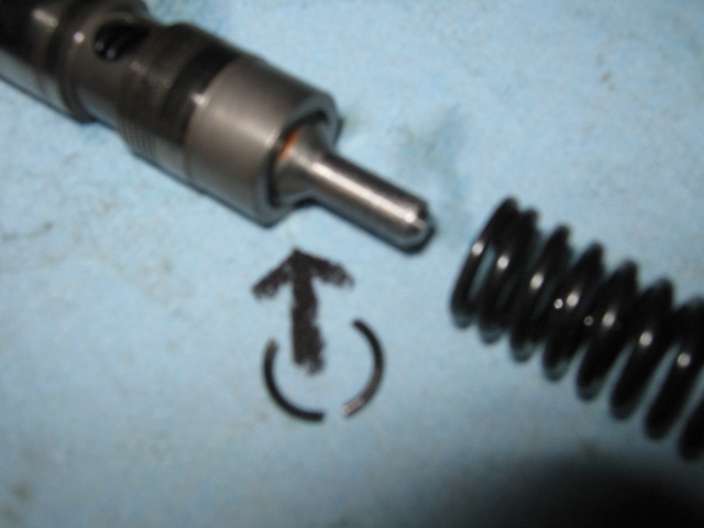

BigMike915 , did you ever get around to removing the 3 pnt lift valve? I found the photo I had taken of when I took it apart, although the part the arrow is pointing to also comes out and this part can get stuck and needs to be polished up for smoother action,, In order to remove this part you have to locate and pull out 2 half ring looking clips, at first I thought this was one pc that had broken, But it is made this way I guess for easy assmbly/removal,
I could not find a breakdown image on this assembly so I hope the one I have here can help better to familiarize you with how it's suppose to go together,
