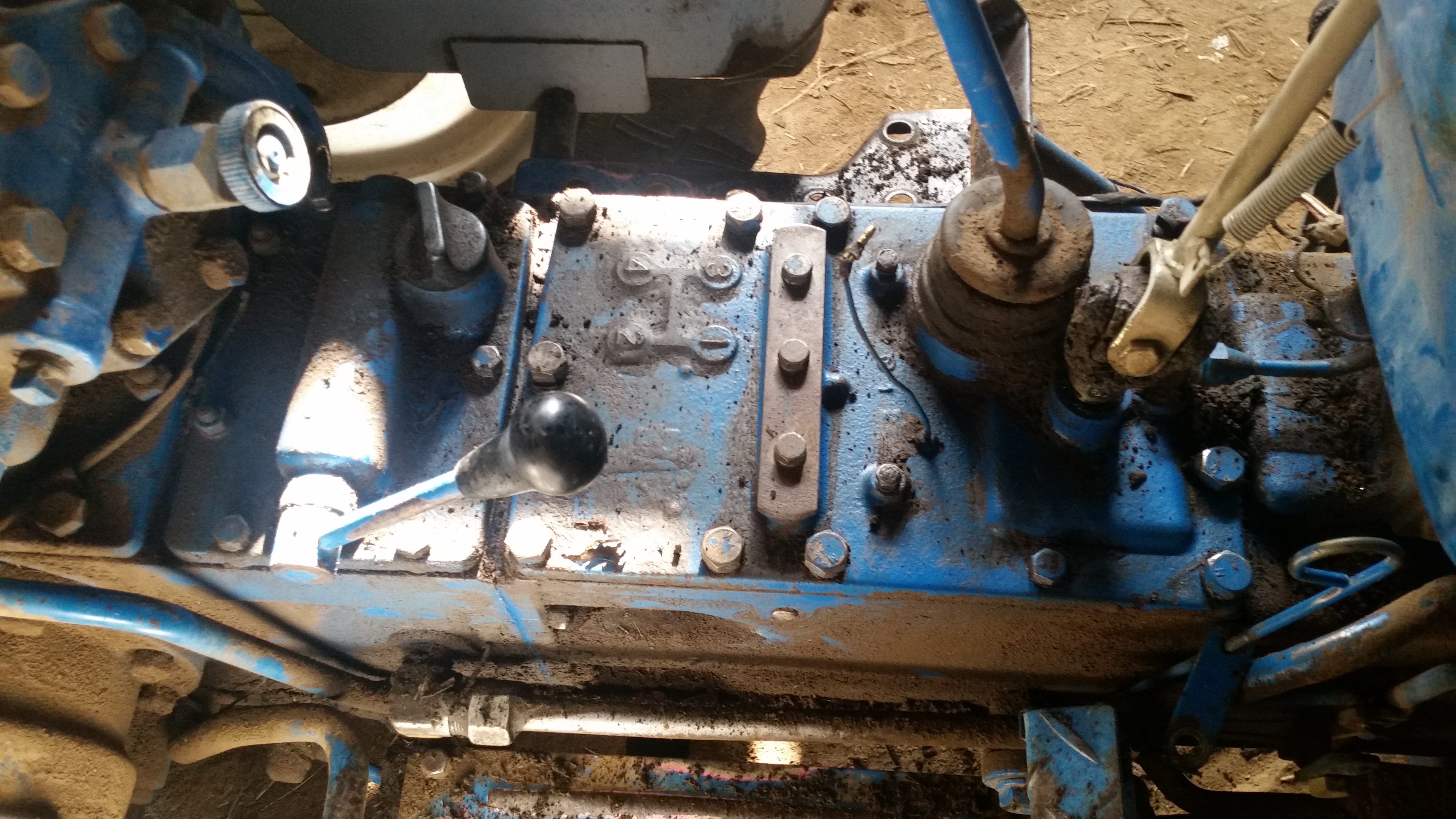

I have a 1710 it pops out of reverse have replaced the detent springs did not fix it, any other ideas

Hi Mgoldman,

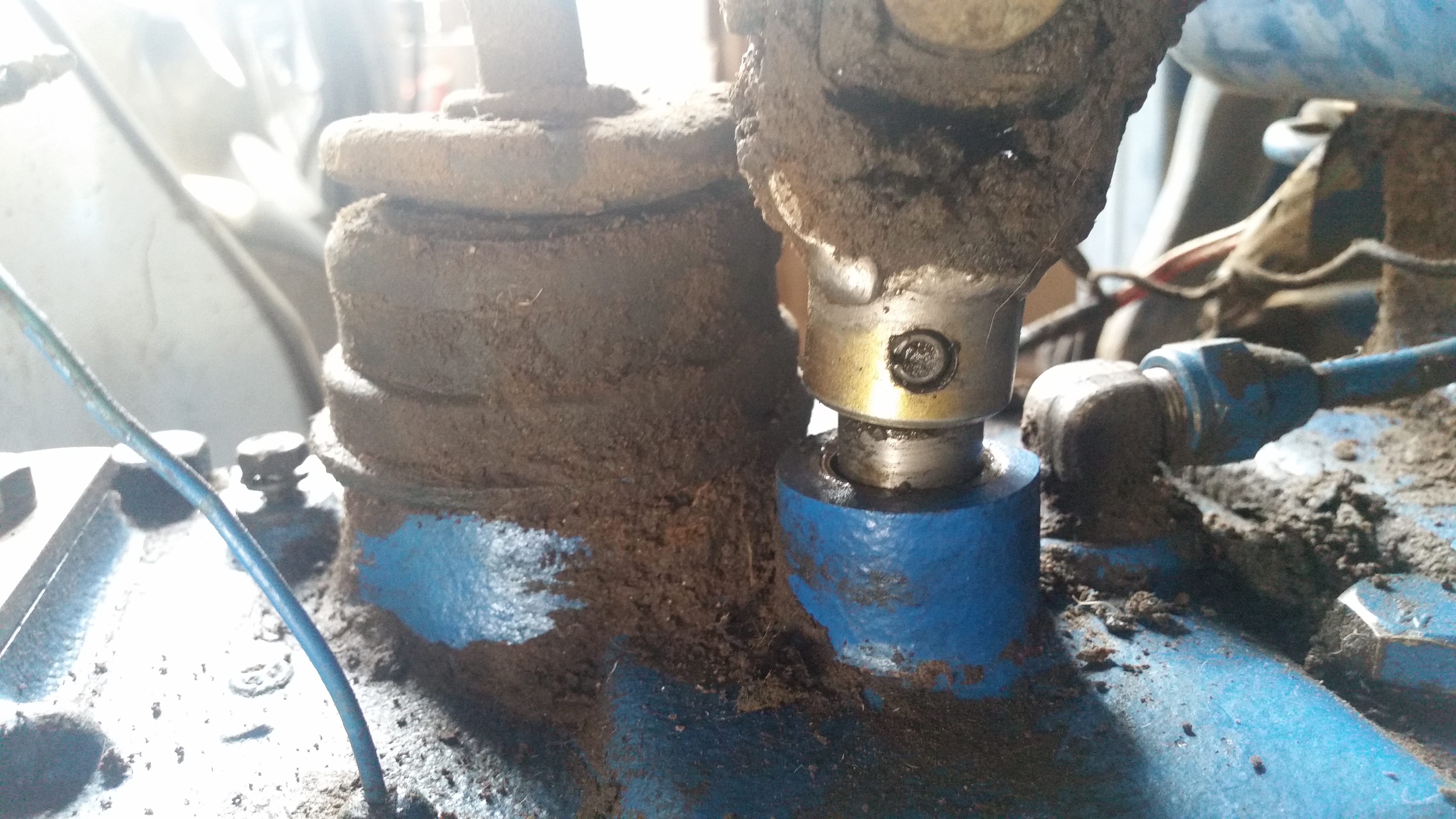

Took off the cover for the bottom part of the shifter linkage, just before it goes in to the transmission. The U-joint was ok, but the last fitting with a pinned connection was a sloppy mess. Going to take off the transmission cover and shifter linkage to determine how to reduce the slop. Probably will be a shim to fill any space between the pin and coupling, then a larger diameter drive pin to hold it together.
   / 1710 popping out of reverse #4
Hi Mgoldman,
Here is my 1710 transmission cover:
The U-joint on the right hand side of the picture is the problem.
Here is the U-joint linkage:
Here is the transmission with the cover off:
The gears look good, and the shifter yokes are not sloppy at all. You can see inside the transmission the two red blocks are the 4 range selectors. The two grey blocks are the 1,2,3, Reverse selecctors. The two small white yellow blocks are magnets for the neutral start lockout sensors. The issue with my shifting is all in the linkage. Where the shaft comes up out of the transmission cover and is pinned in to the bottom of the U-joint was loose with quite a bit of play. I am going to bore out the U-joint, machine the shaft back to round, and use a bushing to get everything tight.
