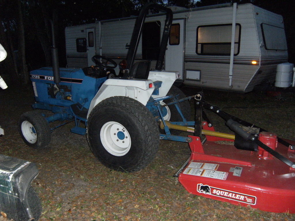

Good info for me too, as I also just purchased a 1720 and might want to add a loader in the future.What kind of tires do ya'll have on your 1720's?I'd like to have the R1's but don't want to pay $1500.00 for wheels from my local New Holland dealer.Does anyone know where I could get them for less.Here's a pic of mine at hunt camp.:D
   / 1720 FEL
I have 12.4-24 R1's on the back of mine, I forget what size the front R1's are. Your tractor looks pretty good.

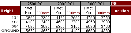

I am impressed. You did your homework well! Here is a visual example of what moving the point of measurement means to the lift capacity of a FEL. It also shows how the psi can skew the capacity numbers when you are trying to compare apples to apples. It's for a little larger loader, but the concept is the same.
