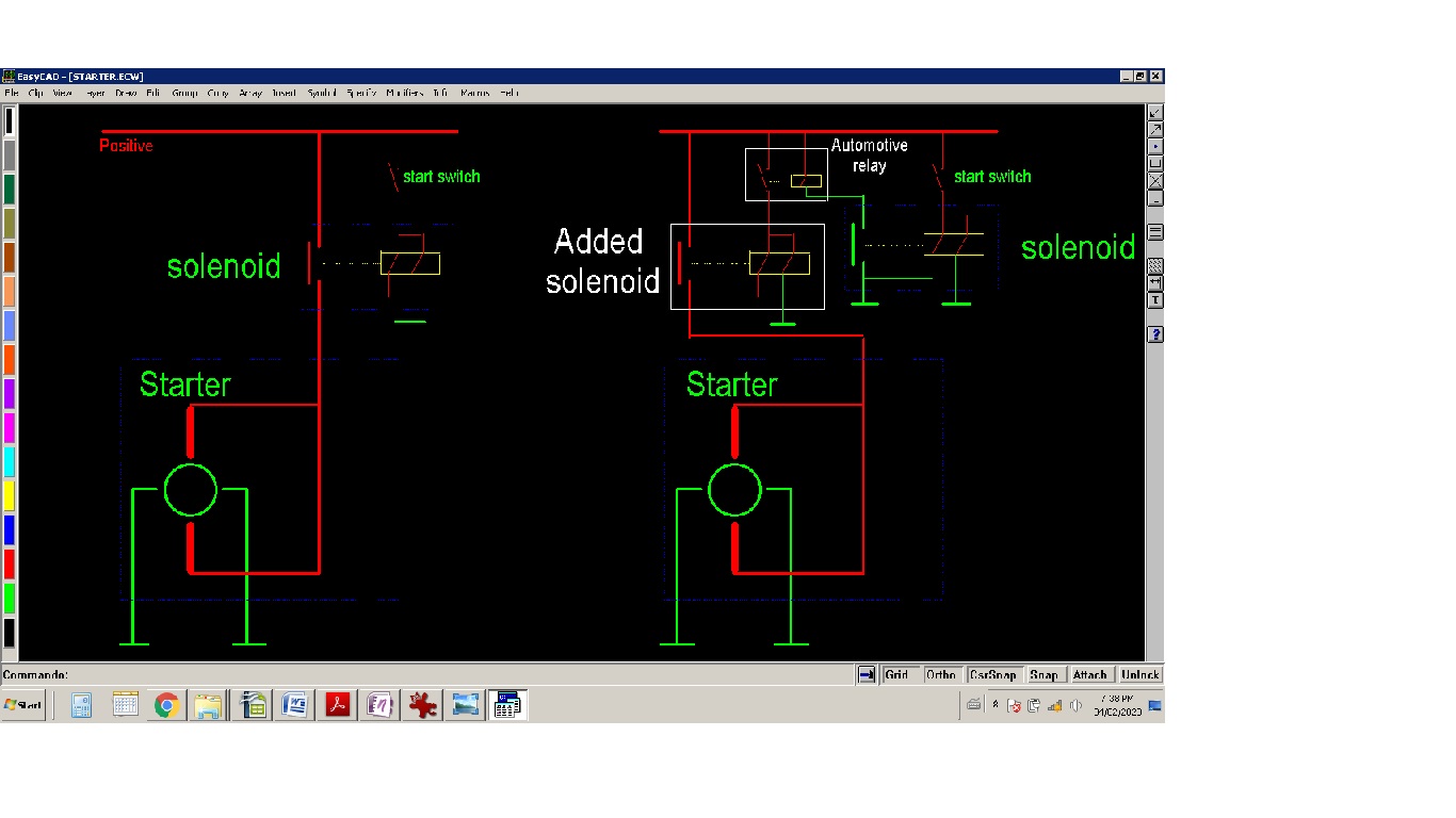

I am thinking that with replacing the starter button by a small automotive relay you can make it work with the key only.
The right image shows how the big starter solenoid contact is used to switch the automotive relay to ground. The automotive relay positive would be powered from the contact switch.
If the key is turned to START, the solenoid on the starter is energized and is pulling the drive gear in the ring gear. The contact in the starter solenoid closes and the automotive relay is energized. Than the added solenoid is energized and the starter turns.

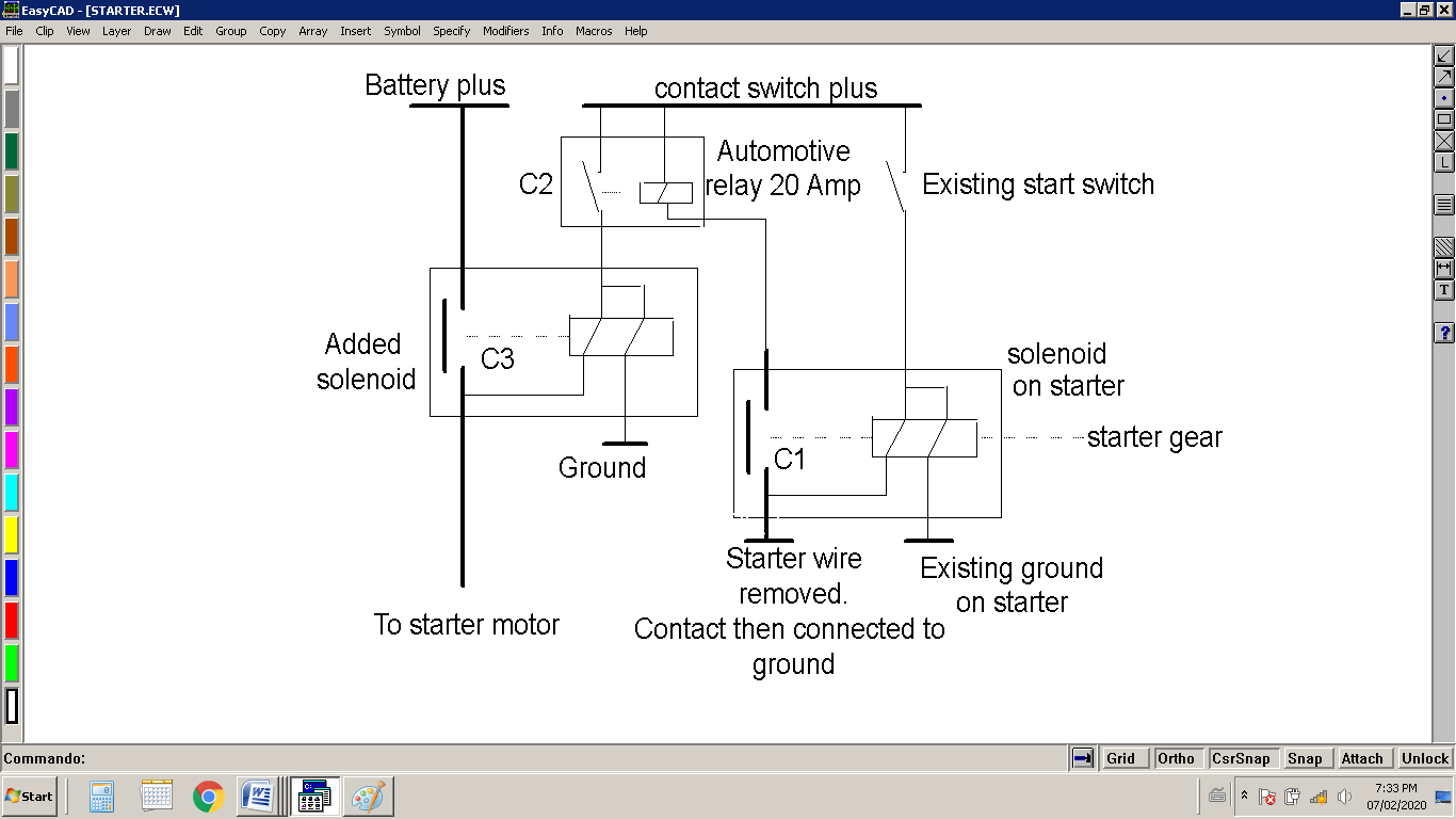

Your drawing only adds an additional switch between the battery & key noting else.
My additional solenoid separates the 2 functions that happen simultaneously when the starter is engaged.
I bypassed the starter (motor run) contacts in the solenoid switch so the solenoid would only engage the starter drive gears.
The additional solenoid energized the motor to crank the engine.
The reason the starter was not engaging (grinding) is because the side of the gear on the flywheel where the starter gear enters is rounded over preventing the starter from properly engaging as the starter was turning.
By allowing the starter drive gear to Firmly contact the ring gear before the starter is turning the grinding is prevented.
I apologize if my explanation is confusing. I would illustrate with a drawing but I’m terrible at it.

This does exactly the same as you are describing, but is using only the start switch to accomplish this.
I hope this diagram explains better what I suggested.
The starter wire on the starter solenoid is removed and connected to the added solenoid. Then the freed connection is connected to ground. The battery wire is removed and connected to the added solenoid. Then a standard automotive relay is added to the circuit.
Click on the picture to enlarge.
How it works; when the existing start switch is closed, the solenoid on the starter is energized and pulls the starter gear into the flywheel gear. (Or against it because it is not turning) At the same moment C1 is closed and the automotive relay is energized and C2 is closed. If C2 is closed then the added solenoid is energized and C3 is closed and the starter turns.
After releasing the start switch all contacts open and the starter gear moves back.
Only one switch, the start switch is used for starting.
