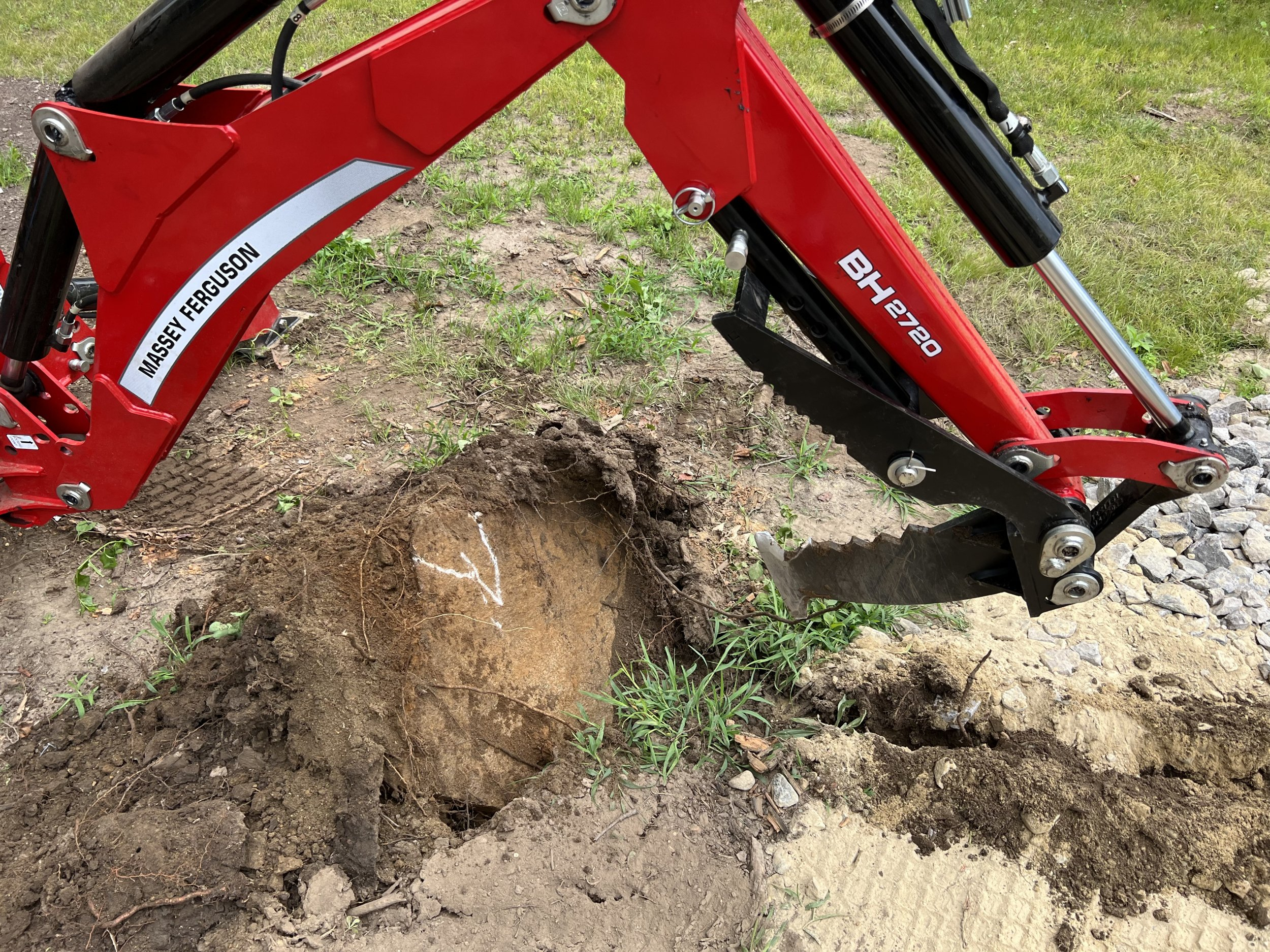

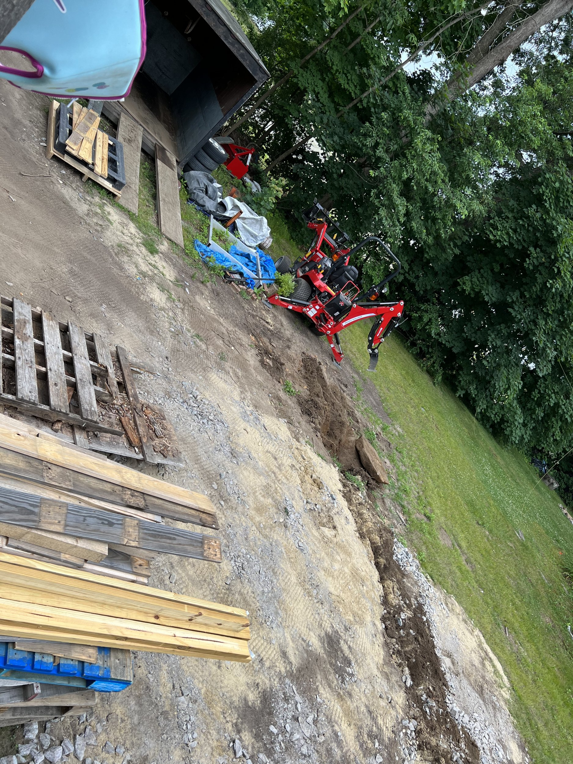

Ive greased all the fittings every 10 hours so far. I skipped the backhoe one time because I didn’t use it for a stretch during a lot of loader work. I took the backhoe bucket off to put a root ripper on and the pins were still greased up nice. I’m installing a underground dog fence wire and using the root ripper to cut the trench.it’s worked pretty well so far. I have found a couple good sized rocks. Actually now thinking about it I forgot the pedals haha. I’ll do that today when my load of 3” minus arrives, or when I get back to the fence install.
