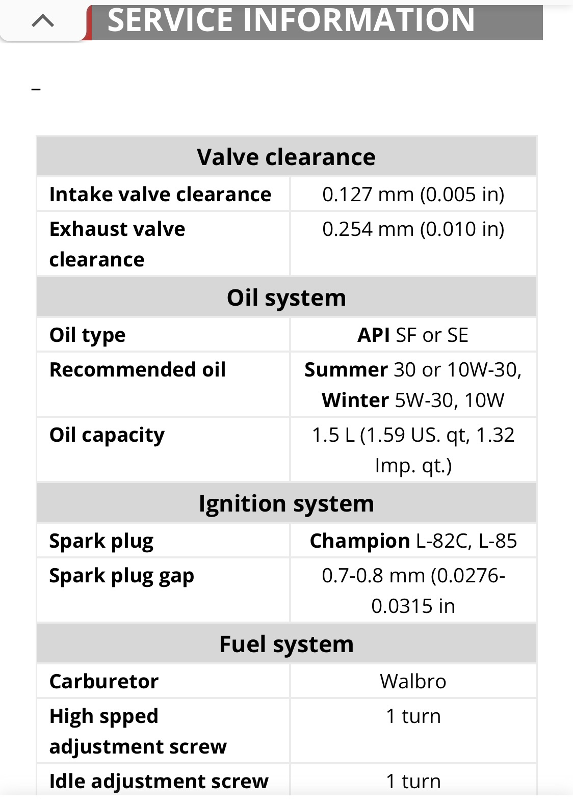

What’s the valve lash setting on a 1816b
   / 1816b valve lash #2
Got this off the internet for a tecumseh HH160 engine.
