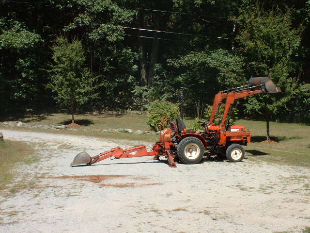

I am not new to this board but I am a new user. I figured this was a good time to share some of my experience with the YM186D that I picked up last fall.
This is a complete Yanmar tractor loader backhoe unit with 200 hours on the meter but I would guess it has gone around once putting it at a more realistic 1,200 hours. As best I can tell this has always been a tractor loader backhoe. The loader is a Yanmar YFL-650 and the backhoe is a frame mounted Yanmar YBH-660. The tractor runs like a top, the loader seems OK too, but I decided to recondition the backhoe. The backhoe broke a swing cylinder gland at the chain pin lug due to age (clean break) and as with anything I do it seems I kept making more of a project than a simple fix. So, short of paint the backhoe is now like new with repacked rams, new hoses throughout, one new control stick valve, both swing cylinder glands are new, and so on.
I'll post a few old pictures for now and take some new ones shortly.

that's a great pic, I would love to see one in closer to see how it all works.
Where do you operate the BH from?
Good looking machine!
   / 186D info sharing #9
From the picture, it looks like the tractor seat flips up out of the way and the BH seat flips down for operation.

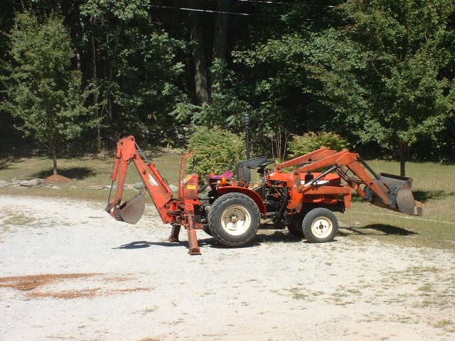

Mike - I have thuroughly scoured this forum, the old Yahoo group, and the net in general for 186D info. I read your threads as well and I am seriously thinking about doing that top link reinforcement plate modification because I would hate to have what happened to your tractor happen to mine. Lucky for me though that mounting area is not being used on mine as the backhoe mounts on the frame.
Ozarker is correct. The tractor seat flips up and the nasty purple aftermarket replacement seat flips down. See the attached picture. I will get the tractor back next week and will be able to take any pictures you want but for now this one will have to do.
