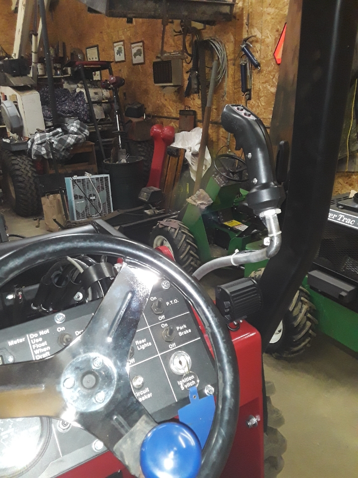

Same as my 1430, I installed a diverter valve in the hoist (loader raise/lower) circuit. Then a Scorpion joy stick that has a trigger and 2 push buttons. The trigger switch changes from hoist up/down to implement, so that closes/opens the grapple. Rayan's log grapple comes with it's own diverter valve to change to rotate, so I wired it for a push button on the joy stick to rotate the grapple.
It is much faster as you might expect not having to remove your hand from the loader control handle to change over to the implement. Takes a while and I am still learning, to not have to move the lever, just actuate the switch. For instance when you grab a log by pulling back on the loader control and squeezing the trigger then just release the trigger after it grasp the log and the loader starts to raise.
I was thinking about installing a hyd thumb on the front (back)hoe. The thumb would be controlled by the old PT quick attach circuit and the hoe bucket would work off the trigger switch hoist control.

Here is a pic of the joystick and the bent up lever to lower it.
