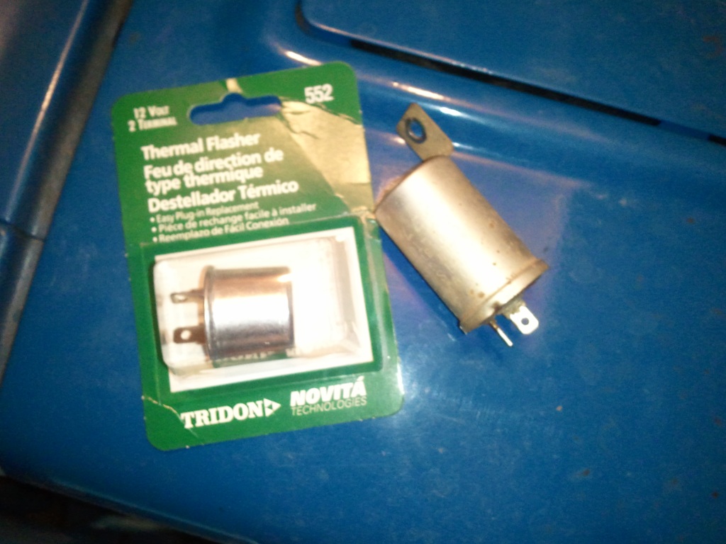

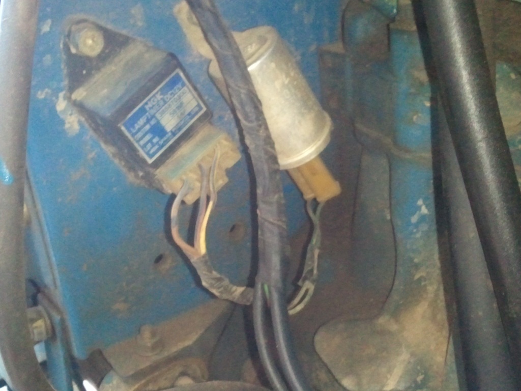

My hazards lights wont flash (man this tractor is killing me) on my 1991 1920 sss.
I found the relay and it looks the flasher unit (or capacitor?) may be bad. I jumped across the unit/capacitor and the lights came on steady.
I cant find this thing anywhere. NH and Messicks list flasher parts for tractors newer than 1993.
Can I get the original or is the NH/Messick parts direct replacements?
Thanks again guys.
Picture enclosed:

Unplug the flasher unit ( silver piece) and take it to an auto parts store. I bet they have a flasher unit that will work.
   / 1920 Hazzard lights wont flash. #3
That appears to be a standard 2 pin flasher as suggested by dqdave1. Be cautious and not buy the heavy duty flasher because a heavy duty flasher assumes there is a large number of lamps and on a small tractor it might cause the flasher to flash too fast or too slow. Get the standard grade it will last for years.
Craig Clayton
   / 1920 Hazzard lights wont flash. #4
Looks like a 536 flasher, 2 blades, power in and power out. 537 has 3, third is for an indicator lamp.

Got one from Autozone and it did the trick.
Thanks!

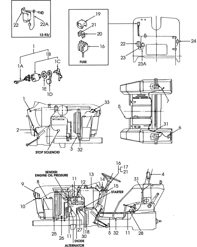

#22 SBA385230230 RELAY Relay, Hazard, Start Year: 12/01/1993
