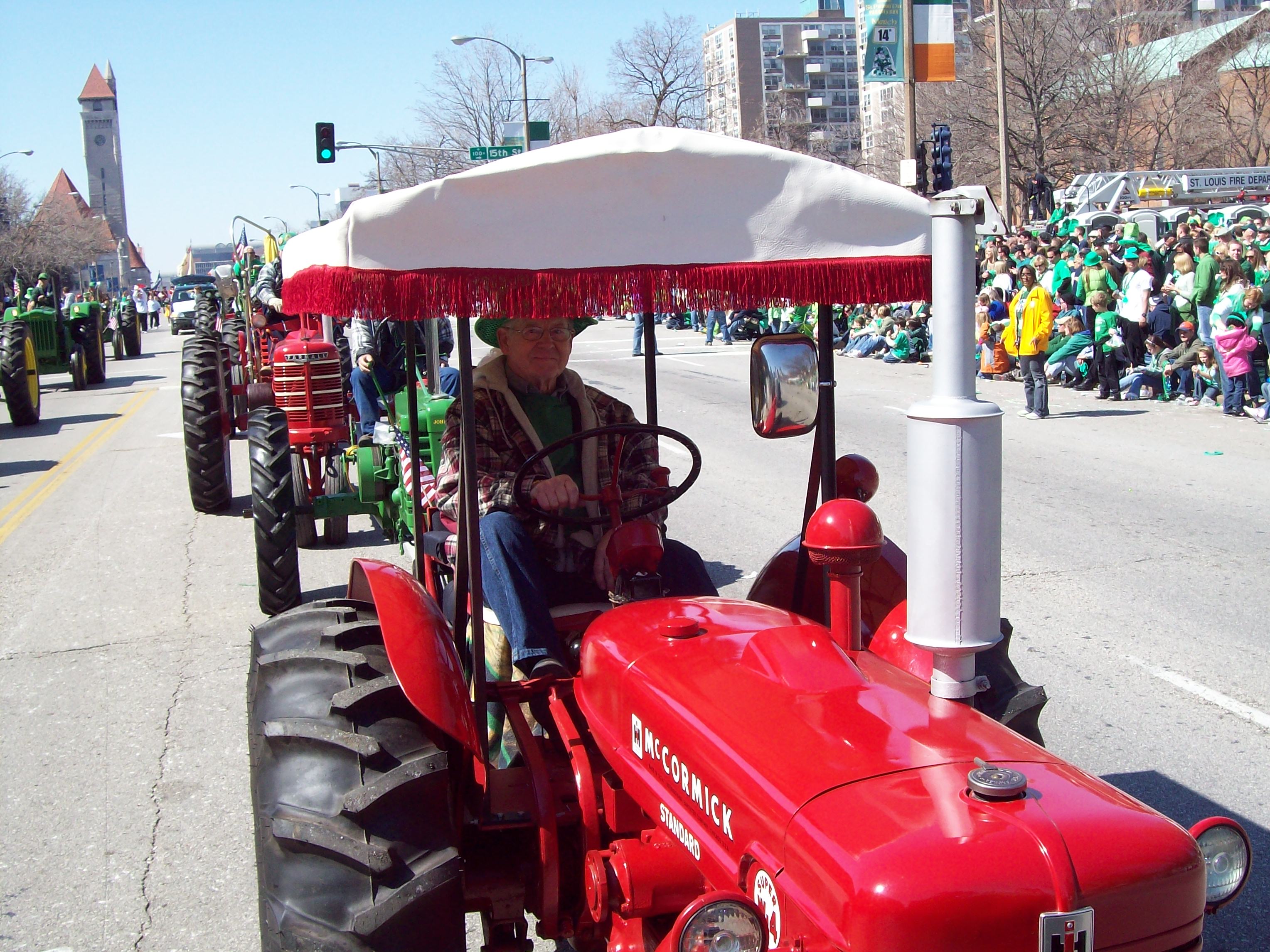

Hey there, coffeyp. Send us some pics of your old M. My Dad is finishing up a resto on the 1952 H that we farmed with years ago. Here is a pic of his super W-4 with rear seat and surrey top.:thumbsup:

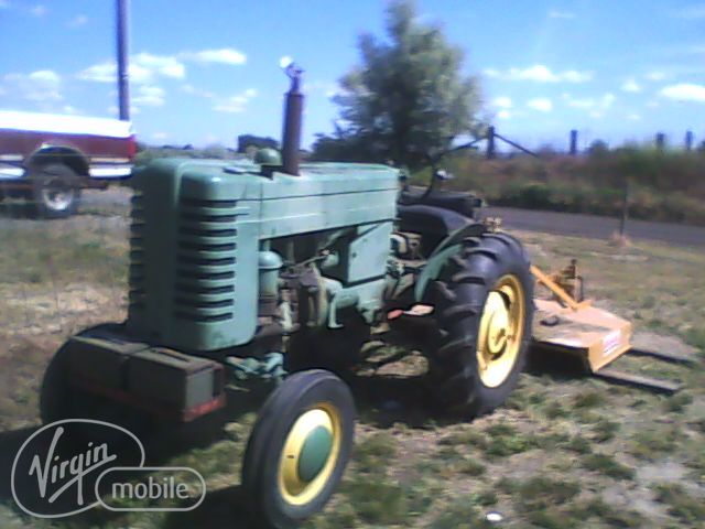

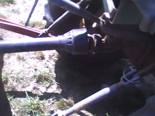

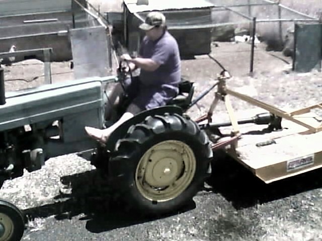

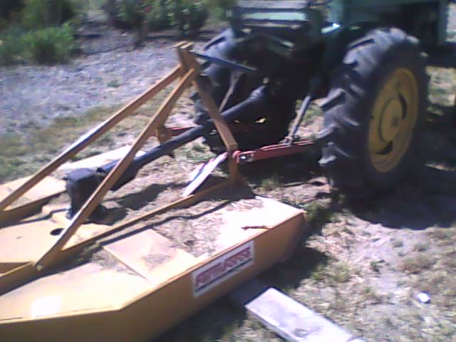

i have a John Deere M, i took the old hitch off of it, and got some parts for a ford 8n, for my 3 point change over, i had to make up some sway bars for the 3 point, or you well eat up the tires , works fine on my m, i have a blade, and 4 foot mower i use, i have used a tiller on it also with my 3 point set up, just get the pins and bolt them in place under the tires, there are holes there. that you well see once you get the old hitch off. and i took had to mod, the ford adjusting arms,
   / 1947 M refurbishing #6
this is a picture of my john deere m , and the 3 point setup i'm using
