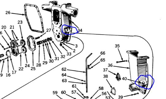

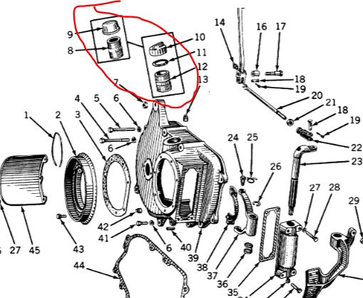

Got everything assembled without any problems. The clutch seems to work as it should. The manual dosnt mention where to add the transmission oil so I removed the cap on the first reduction gear cover and dumped it in there. Is this correct? I,m finding that the operators manual dosnt address this or where to fill the engine oil.
Ken
   / 1948 John Deere B Belt Pulley assembly question #5
Sorry but that's where you add engine oil outlined in red. Trans oil fill is on rear cover outlined in blue
Thanks for the information. Normally I dont make mistakes like this. I better get it drained and start over.
