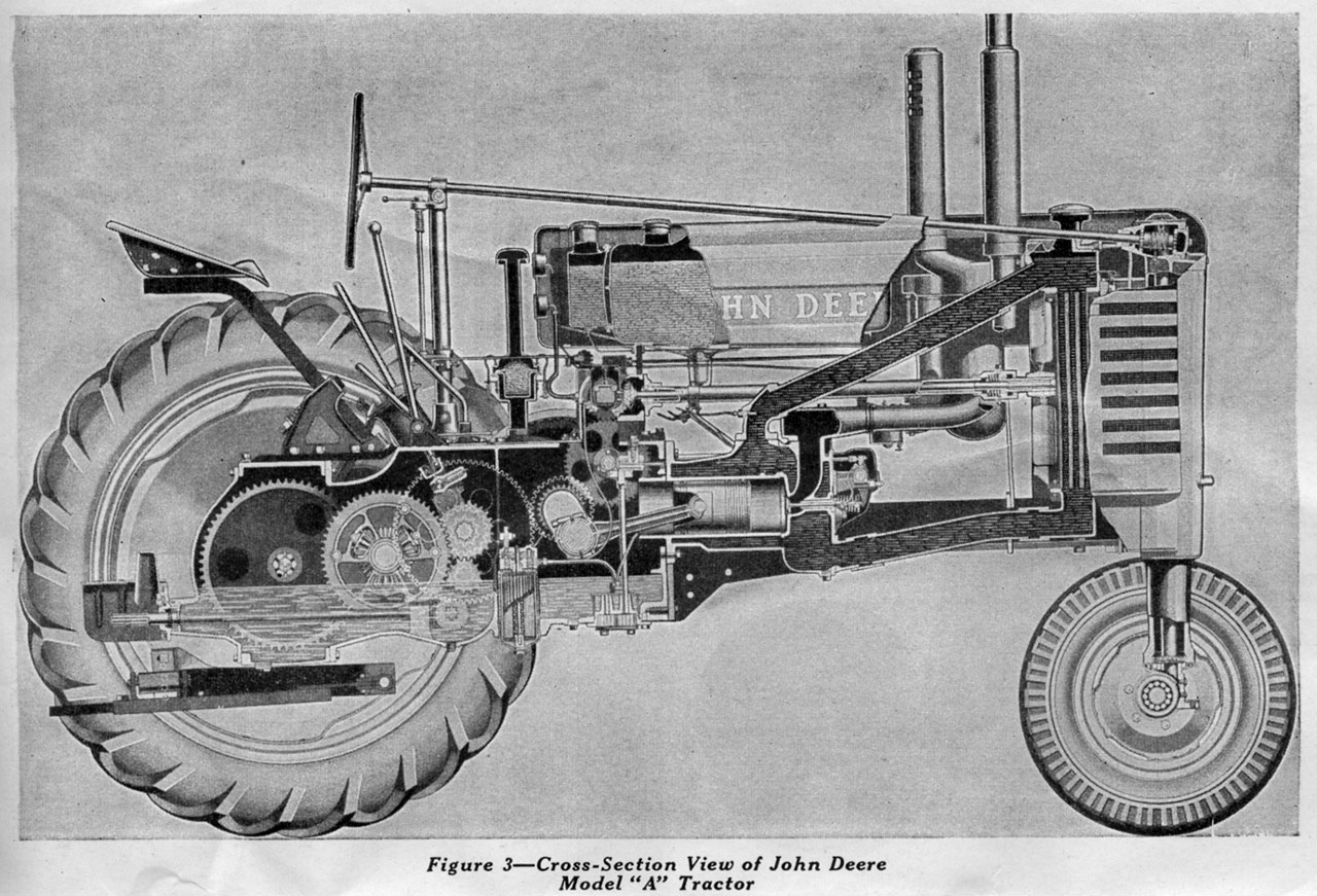

A 1951 JD Model A got me curious as to what it would look like compared to the earlier version...
Then I came across this cool picture:
