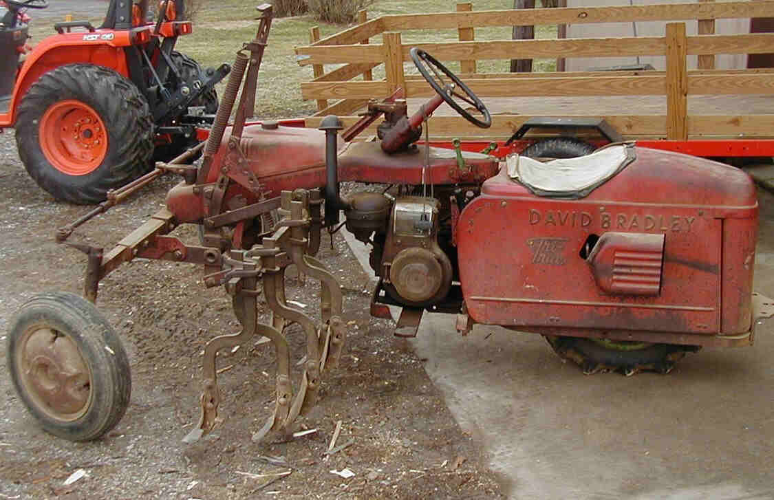

Wondered how many of you would like to see one. In the 1950's, my Uncle was sent to buy a corn planter and came home with a David Bradley. Everyone made fun of it, said it was a piece of junk, would never last, and he wasted his money. She's still going strong and does all my truck patch work every year. Third pull on the rope is a charm - every time.
He bought (sold by Sears) it with the working bar & cultivators, sickle bar mower, harrow, and a two row corn planter (sits on the working bar).
This sweetie weighs in at somewhere around 1400 lbs, liquid and weights in fronts and rear, when the working bar is loaded with 8 heart shovels and a ninth in the back, she never slows down. Power is from a Wisconsin 6HP engine, other than oil changes and new mufflers and spark plugs, has never (in 45 years) had any work done to it (not even breaker points). She was rolled (no one injured) in 59' (steering wheel slightly bent) while cultivating strawberry patch.
Transmission of power is thru a dry clutch and a variable pitch pulley to the forward/reverse gearbox. PTO pulley (for sickle bar) is housed under the offset seen directly under the BRADLEY (in photo). The tractor articulates in the center (in front of the seat) sort of like all wheel steering, and a small crank (by the steering wheel) will allow you to offset the rear wheel to the right or left to accomondate row spacing. The front tread can also be changed in less than 2 minutes to any spacing between 48" and 72".
I acquired her 10 years ago when the clutch started slipping (Sears no longer stocks parts) my Uncle wanted my help taking her to the scrapyard. I had a machine shop custom make the clutch disk and install new sleve bearings and seals. Some minor adjustments and off we went. Two fronts are orig. tires, rear (7:00 X 16) bar tread was replaced two years ago.
After this growing season I can dis-assemble - clean - and repaint her.
Hope to get a group shot of all the tractors out on a sunny day!

Holy Cow, Steve! I never saw anything like that in my life! /w3tcompact/icons/shocked.gif
If anything would be worth restoring, it would be that puppy. A classic, fer sure! /w3tcompact/icons/wink.gif
Thanks for sharing.

And it's truly AMAZING how much traction I get from only one drive wheel.
It's great for Row Crop work. The cultivators are right under your nose. (The muscle powered lift is prone to fatigue, but the seals don't leak!) Same for the planter. In the photo the shovels are set to hill up potato rows.
Big problem though is it tips over very easy if you are pulling a wagon with any kind of a load and go into a turn. I keep the front end set to 72" and stay on level ground.

That thing looks seriously cool! I've never seen anything like it, either.
<font color=blue>Power is from a Wisconsin 6HP engine </font color=blue>
I swear they used to measure HP differently /w3tcompact/icons/wink.gif. I have a late 50's Gravely Model L (2 wheel walk behind) "tractor" with what they claim is a 6.6 HP motor - if I hooked that up to my 12 HP riding mower, the Gravely would pull it backwards /w3tcompact/icons/shocked.gif. And unless you think it's gearing, these babies have two speeds - medium and fast!

Steve,
That is one fantastic looking old lady! /w3tcompact/icons/smile.gif /w3tcompact/icons/smile.gif!!!
You've got a real treasure there! I look forward to seeing her all gussied up!
Notice a little more of that neat trailer behind your other new toy too. Please fill us in on it when you can!

For yesterday iron she in darn good shape.
I believe Allis Chalmer,Case also had tractor setup like the D.B. but a little larger.
I bet she would bring home some ribbions if you enter her antique tractor show. /w3tcompact/icons/wink.gif

Are you sure Harley Davidson didn't have something to do with the design?
That is some Hog!! And I'll bet it's paid for itself many times over.
