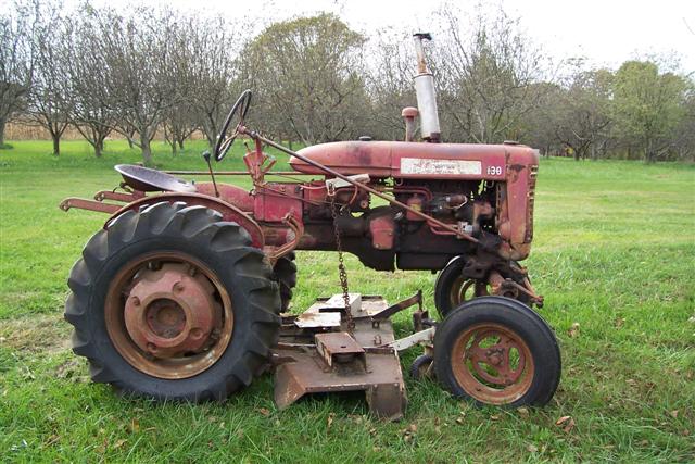

Thanks for all the quick replies! I really appreciate it. So it looks like the majority belives to be in the $2000-2500 range, not bad for a tractor thats 49 years old! And thanks for posting the serial numbers vs years, I had seen that but I guess it didn't register. :) It has been a great tractor, I live next door to him and he has an orchard out in the country. As long as I can remember he's used that tractor for just about anything from pulling stumps out to pulling me out when I get the truck stuck. A lot of good memories, of course thats when I forget how mad he was at the time :D.
The only question I still have is the Rockford clutch. I assume its a heavier duty version of the "base model" clutch, but I'm having a hard time finding any info on it. thanks!

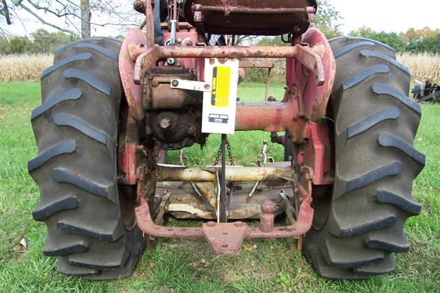

I would tell you to drive it and cut with the mower so you know if slack stering, brakes, make sure tires have plenty of air. I would tell you to get some of the grease off others may not agree. Have plenty of gas in tank so a test drive would not be an embarsement this has happen to me walking back does not help in the selling process. Lots of luck!!
