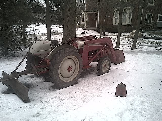

new member i have a 1956 ford 8N i believe switched from generator to alternator (purchased this way) with hydraulic bucket on the front 4 speed transmissions been loosing power when sitting when running runs fine but bogs out and dies in 4th gear on road driving recently cleaned the carb and unstuck float no problems there wiring seems to be fine and battery should be more then charged as jus drove from one property to another bout a 45 minute drive any suggestions on what the potential problem could be about the transmission not like 4th gear or reasoning for loss of power. also if anyone one has a pdf file for a manual or can suggest where to find one much appreciated

lack of power in high gear can be flooding ( stumbling gurgling ), lean (popcorn sounds and hesitation ).. or weak spark.
if spark is good and you think carb is clean.. enrich main jet by 1/8 turn at a time and test her.
lastly.. if she is getitng tired.. a compression check may be needed. many people converted tired tractors to 12v to get ones with lower compression to start easier.
ford spec is 90 psi minimum.. but you can still get some work out of them if all are 80.. if inteh 70's she could be getting real weak.
ont he comp test.. do it on warmed enigne, key of, gas off, throttle open all the way. dry, then wet test.. at least 5 puffs per hole.. though I usually roll it over till the gauge stops climbing just to see the top number. make note of what the first puff gives you.. hopefully is 80% of the reading..
if wet numbers are higher than dry... then may need rings.. if wet and dry are low.. could be valves.. etc..
post back
   / 1956 ford #3
ps.. check condition of spark plugs, gap, and all ignition components. gap plugs to .025
points on a fornt mount to .015 sidemout to .025
