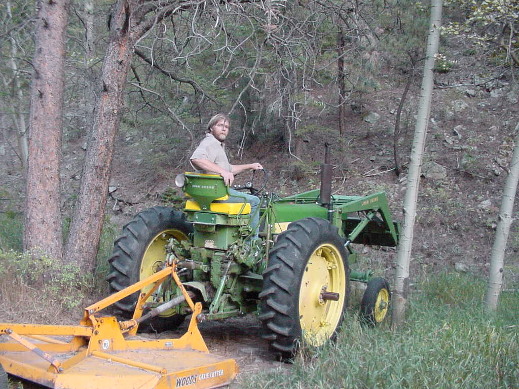

Hope you are as satisfied with the 520 as I am with the 530. One of the things that makes it good is the heavy duty cat II 3pt. Same one was used on the larger '30 series, so the 3pt and hydraulics are super.
In fact, there isn't much a brand new tractor will do that this one won't and it is quieter while doing it too. I'll admit that loader work is a pain with that shifter, but at least the seat is comfortable. Both of those because it was designed as a field tractor and not a utility.
These pictures are from before I got the dual hydraulics from a Green Magazine vender. I wonder if JD still sells that option? The wide front if from a much older two cylinder and bolted right up. Some years later we had added the #46 quick change loader. It bolted right up too! It's just amazing just how interchangeable those old two cylinder parts are.
Here's some pictures from ten or 15 years ago. Looking at them reminds me just how many changes this tractor has been through. Wish I had some really old pictures. Seems like every time I look at some part of that old tractor I realize I've done something or other too it. Hope you post some of the 520.
rScotty
