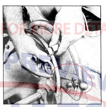

The lever I'm talking about is circled in this image.

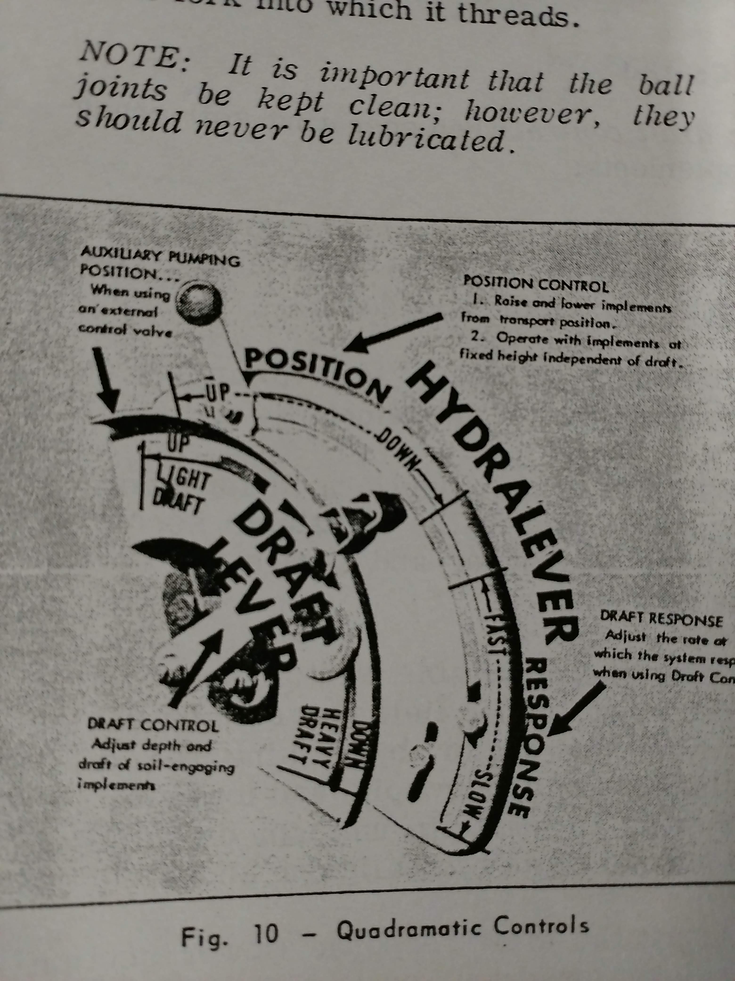

The other level is where? That you are using is the draft control.
   / 1958 MF 202 Workbull HydraLever stopped functioning
I think the draft control levers are separate - they are what the person's left hand is depicted touching in that first image. Here is one from my user's manual that shows them labeled.
So it's the position control lever that is no longer functioning.
(Note: the draft control levers have seemed "frozen" since I bought the tractor, but since all I do is mow with it I wasn't too concerned.)
One other item of note - since Saturday when this happened I noticed the hog dropped back down overnight as it was sitting. So today I kept the position control lever in the down position hoping I could start it up and cut the rest of what I needed to cut, but as soon as I fired it up the mower went straight to the up or transport position. So whatever broke is telling the tractor the lever is up when it is not.
