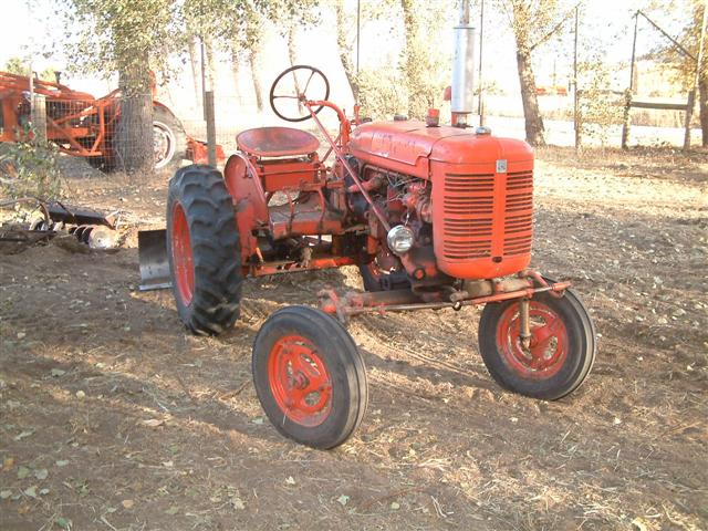

Completely redone? Does this mean completely restored (rebuilt engine, new oil seals everywhere)?
A few years ago I paid $1300 for a Farmall Super A that has very good tires, a 3-point hitch, 6-ft rear blade and a mid-mount sicklebar mower.
Your 140 is the next step up in size from my Super A.
$3K may be reasonable if the seller has done a lot more than just powerwash and repaint the tractor. Otherwise it sounds a bit high since there's no implements included in the deal.
Good luck.
We call that a Rattle Can Rebuild around here!!!
