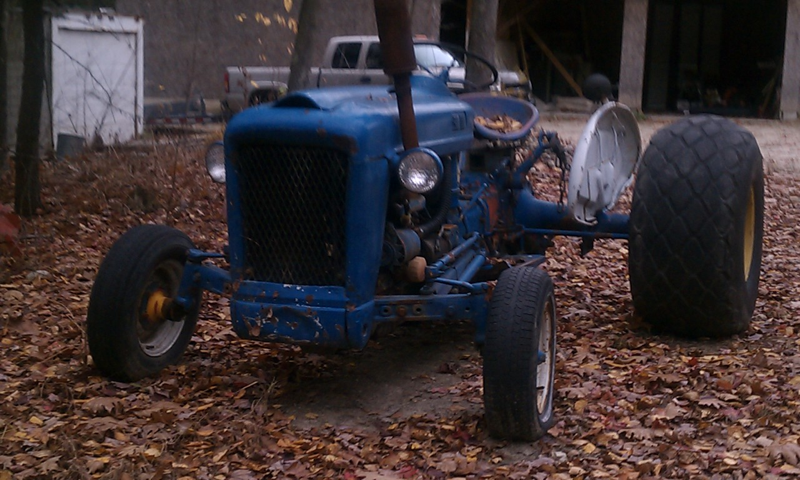

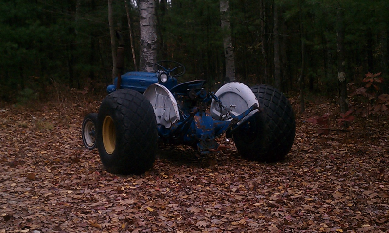

Hello from a lurker,
Any idea of value of this 1964 ford LCG 2000
Issues per seller
It needs a battery box
carb work sometimes drips gas from air cleaner
new key ignition only works sometimes
some wiring for lights and stuff
a power steering pump its missing

ignition switch.. 10$
GOOD carb kit 35$
can of carb spray.. 5$
can of carb dip 20$
wire and lamp switch.. 20$
bat box + cost of angle iron and some 1/8 plate or a salvage or repro. figure 50$
ps repairs could set you back a good few hundred depending on what does or doesn't work in the system..
as is.. I'd have to say.. no more than 1500$ MAX.. and i personally wouldn't pay that either... plenty of better ones to be had at not much more money...

What transmission does it have?
The four speed transmission versions are worth least due to the absense of live PTO. $2000 max. Add a bit if it has a Sherman combination auxiliary transmission.
The Select-O Speed versions are much more versatile due to independent PTO and the availability of many more gear ratios. That said, many folks are afraid of the S-O-S transmission so they usually do not sell for any more than the four speed models.
In this market I would not spend more than $2000 for the tractor described even if it has a Sherman or S-O-S.

quite obviously it has a 4 speed and some sort of sherman, from looking at the pics. shifter handle is visible in 1st pic, thus showing you it is a 4 or 5 speed. 2nd pic clenchis it with a sherman poked out on the left side, meaning it is for sure a 4spd. likely a combo, but NOT an OD only.

Thanks Guys for all the input. I think I will pass on this one.
I have a lot of grass on hills to finish cut,I thought it Might be a bit safer with the wide stance but not looking to overpay.

a lcg set wide WOULD be good for cutting on a hill.
and while a 4spd isn't awesome.. it is fine for hogging... IF it's priced correctly.
if that unit was/is dirt cheap.. go for it. if spendy.. pass on it..
