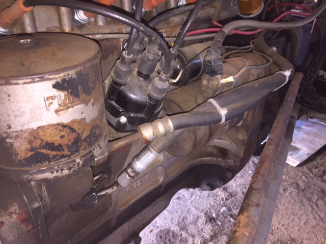

Thanks everyone for a very informative discussion about the timing marks. Would it also work to find TDC by looking at the rotor in relation to the #1 spark plug? Would that be approx. TDC so I could then be close enough to find it by slightly rotating the crankshaft with a wrench?
Also, it sounds like there is just a single timing mark on the crankshaft, representing TDC. If true, do I just estimate where 6 degrees BTDC would be (at idle using a timing light)? Or is there a separate mark showing 6 degrees BTDC?

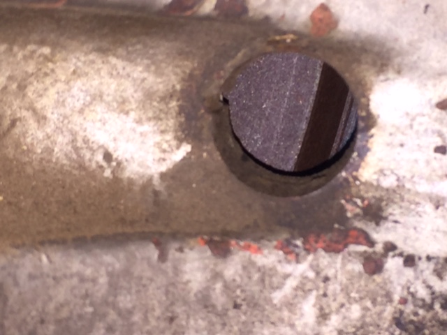

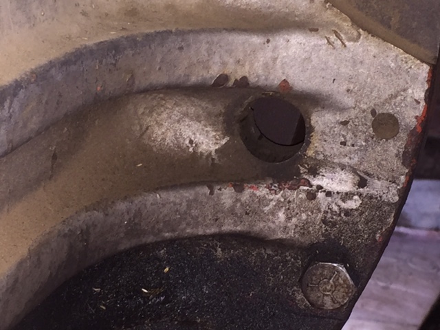

No - the flywheel should be stamped with individual marks that start at "30" degrees BTDC and proceed to "DC". "5" is stamped at 5 degrees BTDC. You should be able to see the marks and quite accurately time the ignition.

Will rotating the crankshaft until the rotor points at the #1 spark plug wire get me close to the timing marks, so I can mark them? In other words, does the rotor pass by #1 plug wire at times other than when it fires for #1? I don't think it could, but am not sure.

With the transmission in neutral, use a ratchet with a 1 1/4" socket on the crankshaft pulley bolt to slowly rotate the crankshaft clockwise. Using a flashlight, you should be able to pretty quickly locate the flywheel timing marks in the inspection hole.
Yes - rotating the crankshaft until the rotor points at the #1 spark plug wire should get you close to the timing marks. But you shouldn't have to do that.
