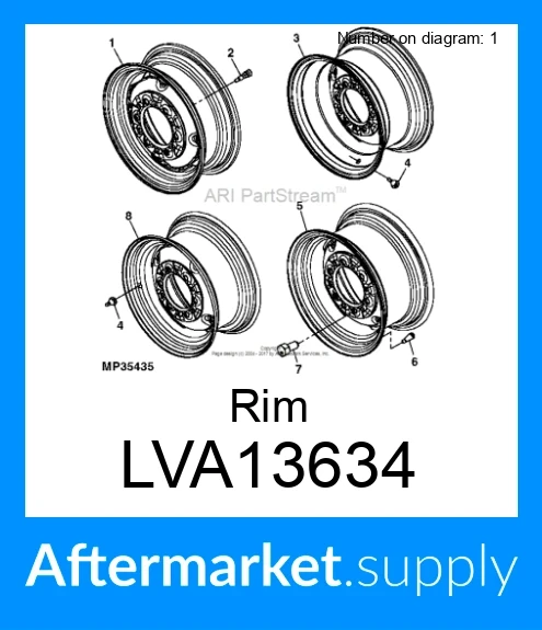

Deere LVA13634 rims. According to online specifications, they are 5X14 rims size with 6X6” bolt circle and 4 5/8 center pilot hole. These specs are identical to the original Satoh Mitsubishi spec’d rims for the S670D.
Not sure if the 4WD front rim would work on a 2WD, but the Deere rim fits.
If the rims don't match, then there is a company that will get you there with new ones.
