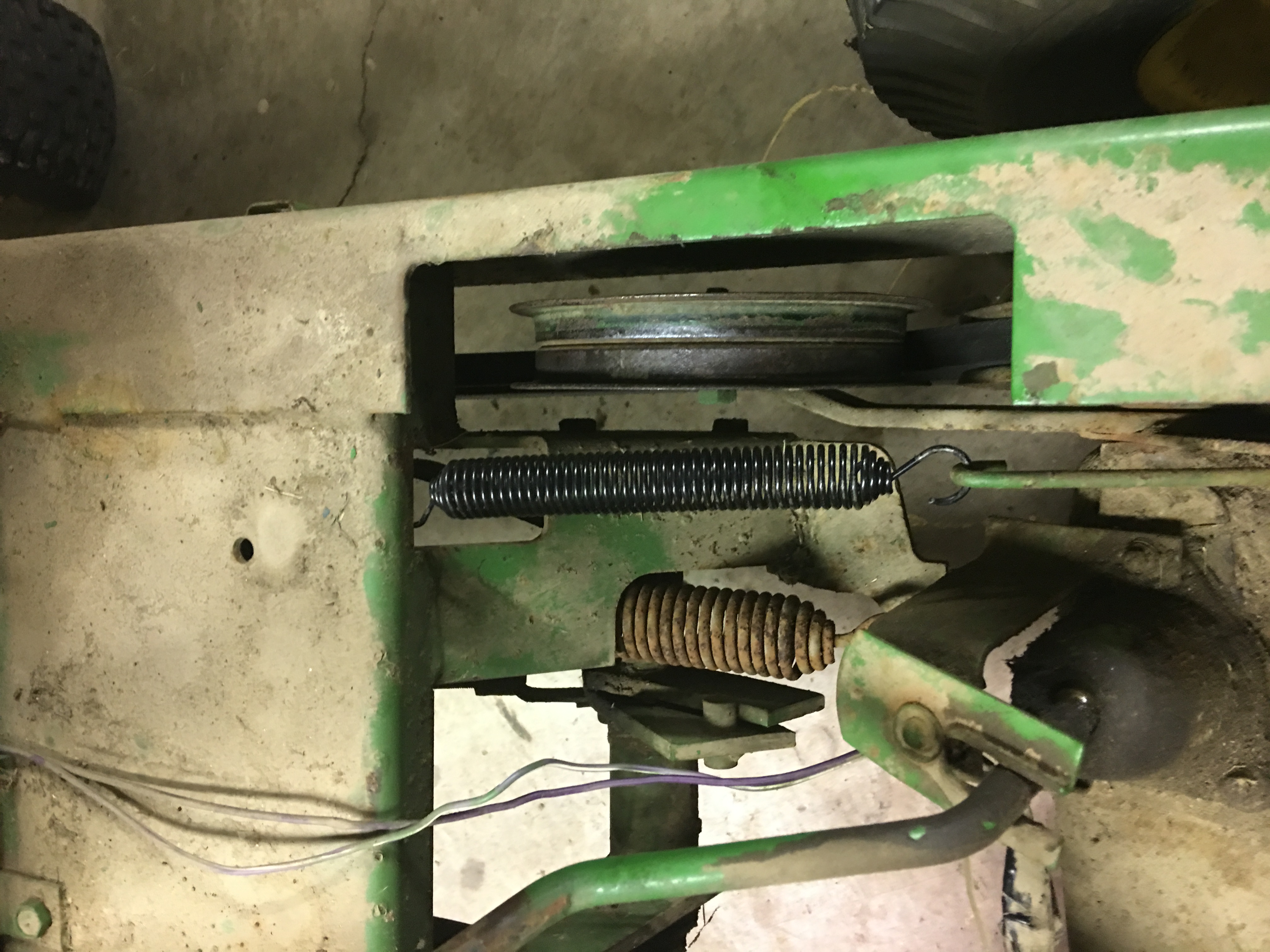

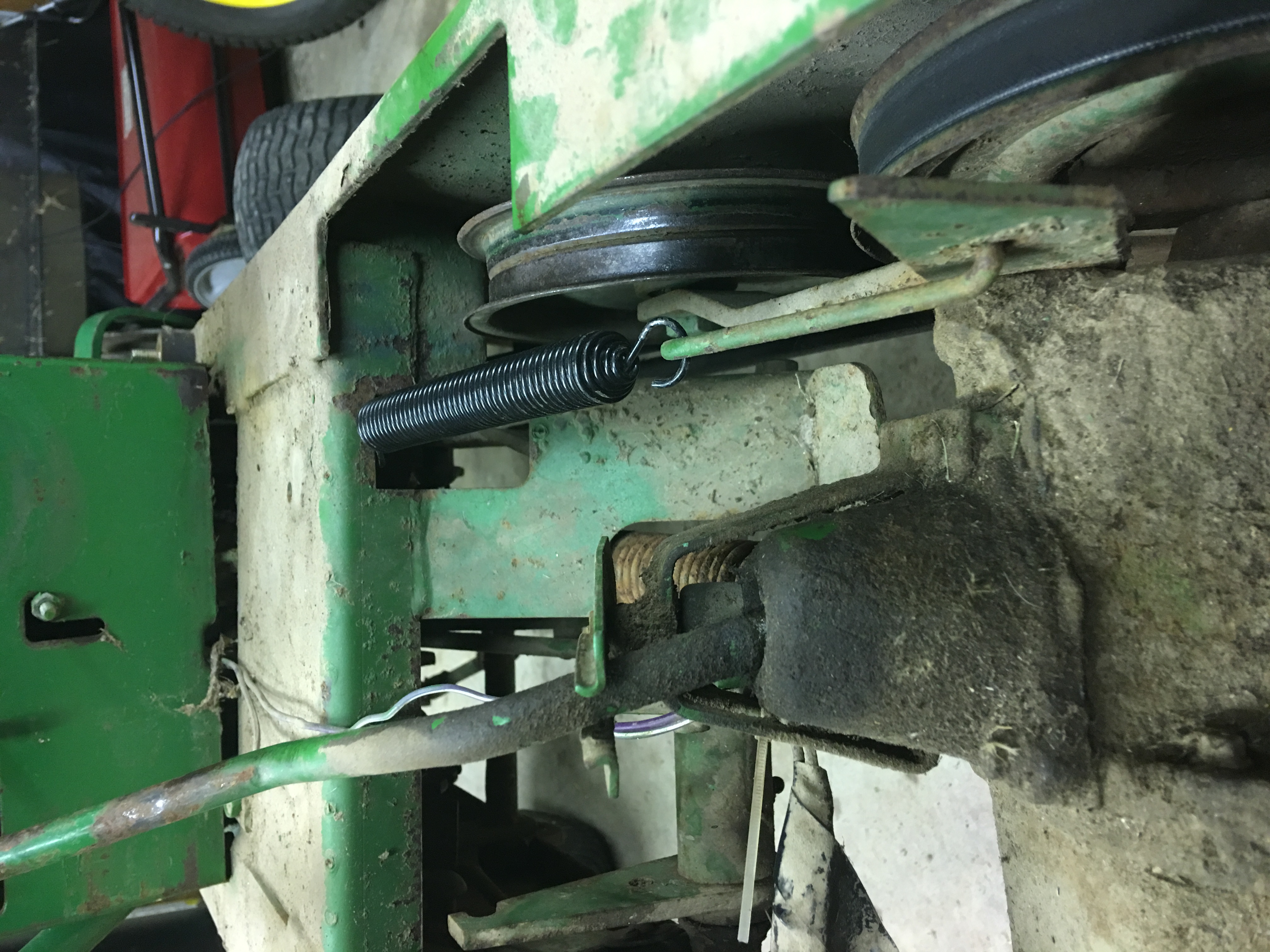

Hello folks,
I have acquired a JD 110 1969 model. It was missing the secondary belt tensioner spring when I got it.
I ordered a new one through dealer and now I am hunting a hole to hook it to. I have the extension rod on the tensioner and it seems that there should be somewhere directly in line or directly in front of the extension to connect the spring to. The only place that I see that would make logical sense is a hole on the cross member directly to the right of the end of the steering gear. This location doesn't seem correct. It is actually left of center in relation to the extension.
Can anyone confirm?

You would think after 50 years that you would see a wear point/ gouge in the hole it hooked into. Can you post a pic?
   / 1969 John Deere 110 Secondary Tensioner

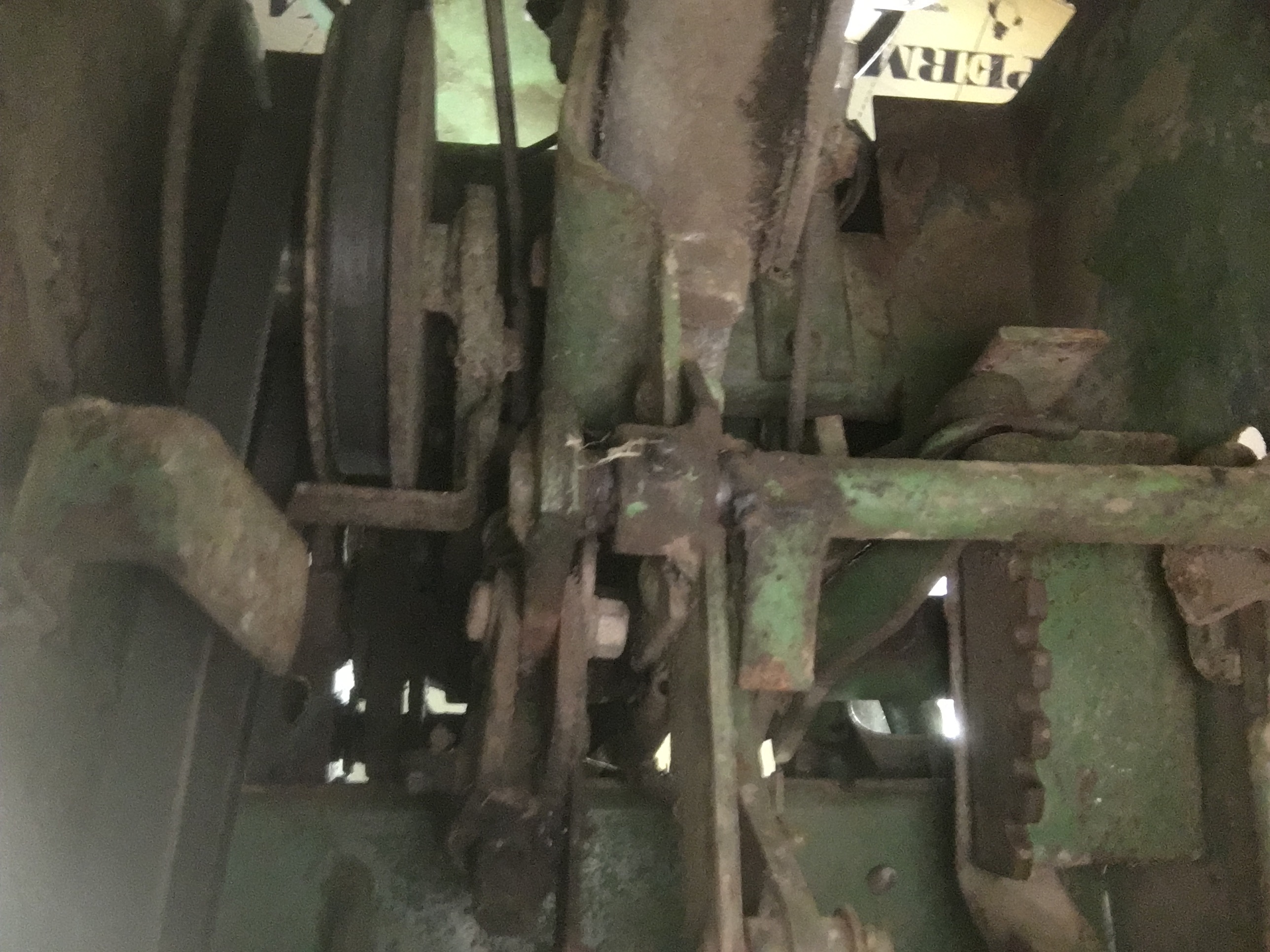

That's what I was thinking. I looked for the usual paint missing and elongated holes, but no dice.
I don't have a very good pic because of the hole location.
I tried to capture what I thought would be the correct path or place to connect the spring in the first pic.
The last pic I tried to take a picture of the cross member and hole location.

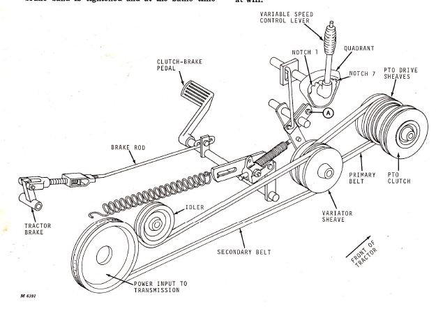

Seth,
I don't know if this is the correct spring for the tensionser as it is not called out, but it looks like it is. This is from a JD 110/112 operators manual.
Richard
