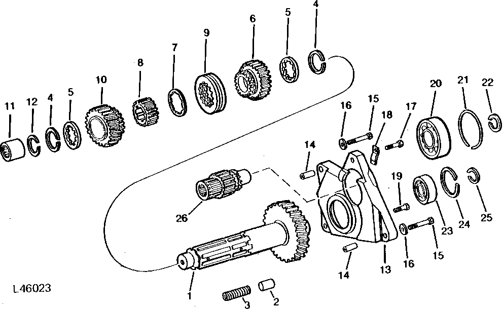

Here's 2 photos of the 820 trans COUNTERSHAFT AND BEARING SUPPORT,1st is sliding gear & 2nd is collar shift trans. It would require a lot of labor & parts to change a 7 speed to an 8 speed(vice-verse). I sold 820's when they were new and have never seen a 7 speed model although they exist.
