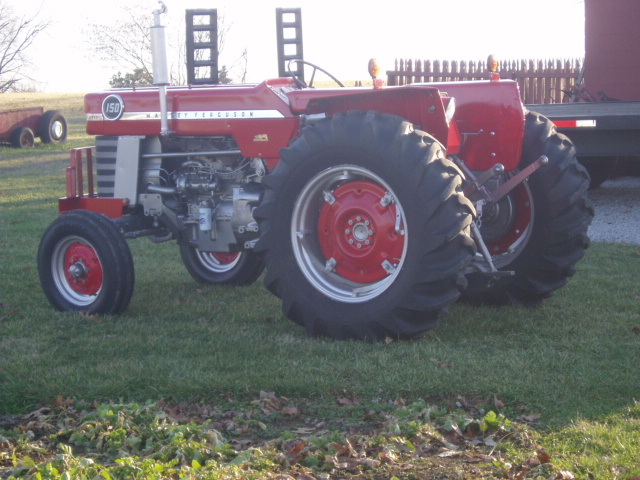

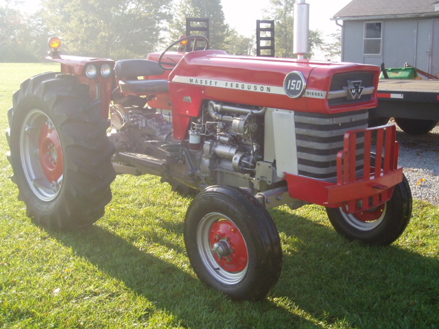

If it's a 1970 model, the average retail price (dealer price for a "clean " tractor) is about $4400. To determine a fair price, I deduct what I estimate to be a reasonable dealer prep ($400), giving $4000. If the tractor has high hours (more than 5000) I deduct another $400. If the tractor looks used (crappy paint, gauges not working, cracked steering wheel plastic, worn tires, loosing steering joints, old battery, lights not working, etc), I deduct another $400.
Last July I bought a 1966 MF-135 diesel for $3600 (big tires, squat look since it's an orchard tractor). The average retail is $4700. It looks used, has some non-functioning gauges and worn tires. But the hour meter is working and shows about 4600 hours and the seller said that he had rebuilt the engine at 3100 hours. Also the seller fixed a problem with the 3pt hitch hydraulics before putting the tractor on the market. I'm satisfied that I paid about what that tractor was worth.
