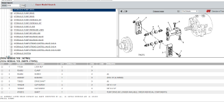

hello everyone! I am posting here for my father. He has a 1973 John Deere 310B Backhoe. He was having trouble with the hydraulics and after a few weeks of picking at it he discovered the problem. The hydraulic pump drive was worn out. He asked me if i could find the part so that he can buy it but i am having trouble locating it online due to the year i guess there is not much if any available online. So here i am on the forums maybe someone here as a part or knows where i can find it for him.
Serial Number is as follows - 150896T
Part Number is as follows - T36523- D2 <---(that D is a guess it looks kinda of worn)

p/n is just T36523, is available from your dealer, over decades they bang around and take out the splines. Replace your clamps and bushings and maybe even bushing studs as they are all most likely worn as well which will accelerate taking out another shaft or worse yet your pump shaft.

I think serial number OP posted is incorrect. Where was this number located on machine? Note serial numbers listed in photo for 310A & 310B
