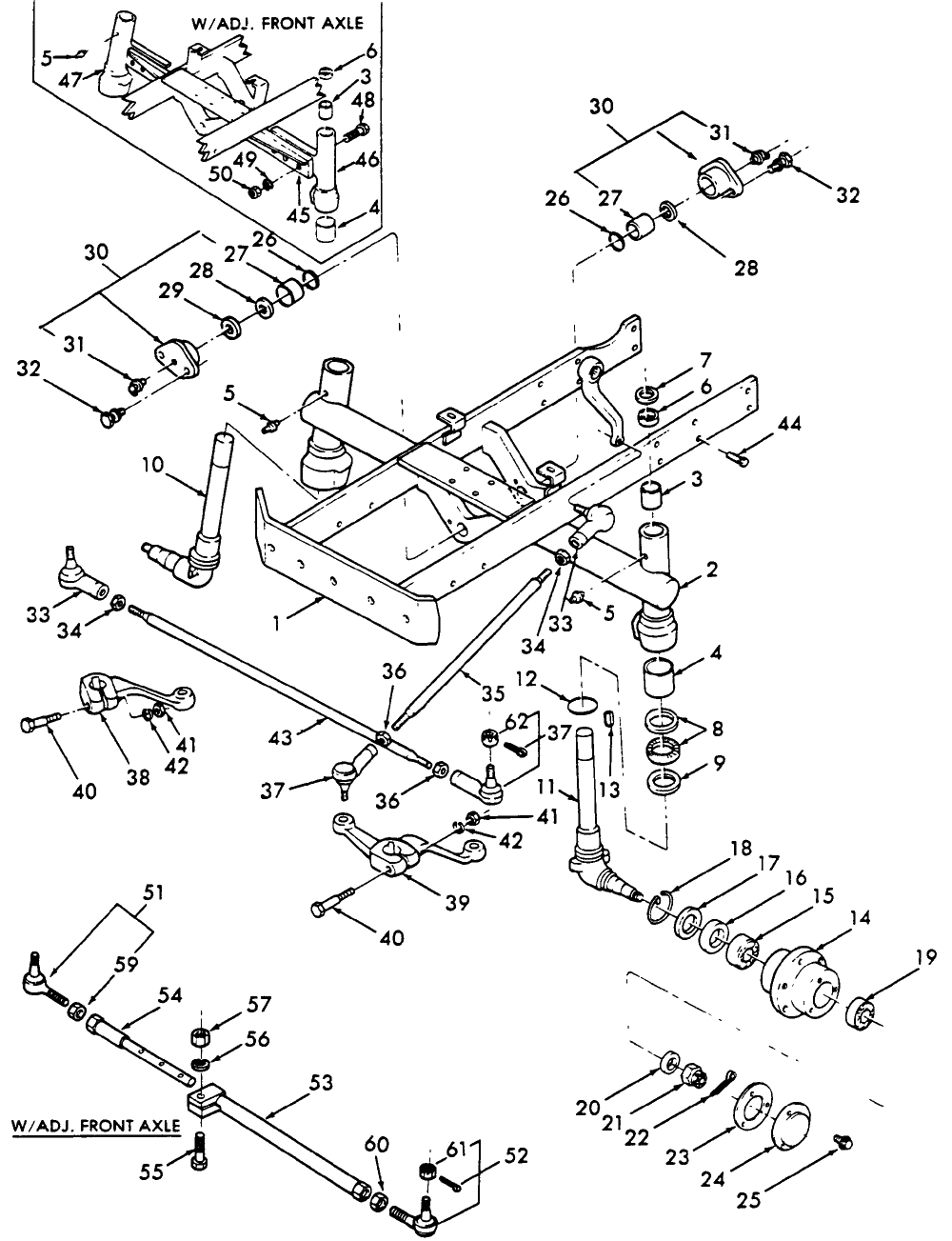

Moving this post from general discussion, hoping to find some help as I am new to posting on this forum. Recently purchased a 1979 Ford 1300 (Shibuara) tractor. Very good condition overall and everything checks out except for some play in the front axle. I want to check the shims but I can't get either the front or rear piovt shaft covers off. These are the covers that have two bolts and a grease nipple in the center. Is there a trick I've missed because brute force isn't working. :confused:
Thanks in advance for your assistance.
   / 1979 Ford 1300 Front Axle Removal #2
I've been into a 1220 and a 1700 front end.. but never a 1300 or apparrently a 1500 that it shares commonality with.
here's a parts listing and diagram of that front end.. rear cap looks fairly straight forward.. any chance of getting an impact wrench on them? ive seen an impact loosen bolts that would otherwise shear off on a straight pull. also dousing with penetrant oil and a whack to teh head with a hammer to swage the threads a bit sometimes helps. if you can get penetrant to the back it would help.. but probably not likely on this design.
1 1 SBA330100560 SPINDLE Support, 1300, Start Year: 01/01/1979
1 1 SBA330100480 Support, 1500, Start Year: 01/01/1979
2 1 SBA330020220 SHAFT Shaft Assy. Includes: Shaft (NSS), Ref. 3 thru 5, Start Year: 01/01/1979
3 2 SBA398510080 DRIVE BUSHING Bushing, Start Year: 01/01/1979
4 2 SBA398510280 DRIVE BUSHING Bushing, Start Year: 01/01/1979
5 2 SBA060620000 LUBE NIPPLE Nipple, W/Adjustable Front Axle, Start Year: 01/01/1979
5 2 SBA060610000 LUBE NIPPLE NIPPLE, LUBE, M6 x .075, Start Year: 01/01/1979
6 2 SBA050309009 SEAL Seal, Start Year: 01/01/1979
7 AR SBA199280490 SHIM SHIM, 0.5mm Thk (.020"), Start Year: 01/01/1979
8 2 SBA398560090 BEARING ASSY Bearing Assy., Start Year: 01/01/1979
9 2 SBA399261040 WASHER Washer, Start Year: 01/01/1979
10 1 SBA330310770 PIN Kingpin, R.H., Start Year: 01/01/1979
11 1 SBA330310760 PIN Kingpin, L.H., Years: 01/01/1979-07/31/1983
11 1 SBA330310760 PIN Kingpin, L.H., Start Year: 08/01/1983
12 2 SBA052300500 O-RING O-Ring, Start Year: 01/01/1979
13 2 SBA034109002 KEY Key, Start Year: 01/01/1979
14 2 SBA330460131 HUB Hub, Start Year: 01/01/1979
15 2 309085 BEARING ASSY BEARING, ROLLER, TAPERED, Start Year: 01/01/1979
16 2 SBA399030030 SEAL KIT Seal, Start Year: 01/01/1979
17 2 SBA399210030 SPACER Spacer, Start Year: 01/01/1979
18 2 SBA398340010 SNAP RING Clip, Start Year: 01/01/1979
19 2 SBA042530205 TAPERED ROLLER BEARING BEARING, ROLLER, TAPERED, Start Year: 01/01/1979
20 2 SBA399210180 SPACER Spacer, Start Year: 01/01/1979
21 2 SBA022200016 SLOTTED NUT NUT, SLOTTED, Castle, M16 x 15, Start Year: 01/01/1979
22 2 PL PROCURE LOCALLY Pin, Start Year: 01/01/1979
23 2 SBA330990011 GASKET Gasket, Start Year: 01/01/1979
24 2 SBA330380160 COVER Cover, Start Year: 01/01/1979
25 6 SBA011150612 BOLT Bolt, M6 x 12, Start Year: 01/01/1979
26 2 SBA052100300 O-RING O-Ring, Start Year: 01/01/1979
27 2 SBA398510080 DRIVE BUSHING Bushing, Start Year: 01/01/1979
28 2 SBA399260420 THRUST WASHER Washer, Start Year: 01/01/1979
29 AR SBA199280190 SHIM SHIM, 0.2mm Thk, Start Year: 01/01/1979
29 AR SBA199280190 SHIM Shim, .5", Start Year: 01/01/1979
30 2 SBA322010580 SUMP Casing Assy., Start Year: 01/01/1979
31 2 80717 LUBE NIPPLE Nipple, Start Year: 01/01/1979
32 4 SBA011511025 CAPTIVE WASHER SCREW SCREW, CAPTIVE WASHER, Hex, M10 x 25, G5, Start Year: 01/01/1979
33 2 SBA334801360 TRACK ROD END ASSY End Assy., R.H., Dust Cup SBA334810070, Start Year: 01/01/1979
34 2 SBA020800014 NUT NUT, M14 x 1.5, RH, Start Year: 01/01/1979
35 1 SBA334710490 SPINDLE Rod, 1300, Start Year: 01/01/1979
35 1 SBA334710260 Rod, 1500, Start Year: 01/01/1979
36 2 SBA020109029 NUT Nut, L.H., Start Year: 01/01/1979
37 2 SBA334801260 TRACK ROD END ASSY End Assy., L.H., Dust Cap SBA334810070, Start Year: 01/01/1979
38 1 SBA334520301 ARM Arm, R.H., Start Year: 01/01/1979
38 1 SBA334520740 ARM Arm, R.H., W/Adjustable Front Axle, Start Year: 01/01/1979
39 1 SBA334600081 NUT Arm, L.H., Start Year: 01/01/1979
39 1 SBA334600140 ARM Arm, L.H., W/Adjustable Front Axle, Start Year: 01/01/1979
40 2 9706717 BOLT BOLT, Hex, M12 x 70, 8.8, Full Thd, Start Year: 01/01/1979
41 2 9706685 NUT NUT, M12, Cl 8, Start Year: 01/01/1979
42 2 412123 LOCK WASHER WASHER, LOCK, M12 x 21 x 2.6 Thk, Start Year: 01/01/1979
43 1 SBA334710530 ROD Rod, Tie, Start Year: 01/01/1979
44 12 SBA011511230 BOLT BOLT, M12 x 30, Start Year: 01/01/1979
45 1 SBA330200280 SHAFT Shaft, Axle, Start Year: 01/01/1979
46 1 SBA330020120 SHAFT Shaft Assy., L.H., Start Year: 01/01/1979
47 1 SBA330020130 SHAFT Shaft Assy., R.H., Start Year: 01/01/1979
48 6 120092 BOLT BOLT, Hex, M16 x 70, 8.8, Start Year: 01/01/1979
49 6 86729275 LOCK WASHER Washer, Lock, 5/8", Start Year: 01/01/1979
50 6 100020 NUT Nut, M16, Cl 8, Start Year: 01/01/1979
51 1 SBA334800690 TRACK ROD END ASSY End Assy., L.H., Dust Cap SBA334810010, Start Year: 01/01/1979
52 1 SBA334800710 TRACK ROD END ASSY End Assy., R.H., Dust Cap SBA334810010, Start Year: 01/01/1979
53 1 SBA334700380 CONNECTING LINK Link, Start Year: 01/01/1979
54 1 SBA334700370 CONNECTING LINK Link, Start Year: 01/01/1979
55 1 325829 BOLT BOLT, Hex, CL 8.8, M10 x 1.5 x 45, Start Year: 01/01/1979
56 1 140028 LOCK WASHER WASHER, LOCK, M10, Start Year: 01/01/1979
57 1 100016 NUT NUT, M10, Cl 8, Start Year: 01/01/1979
58 3 SBA398460050 PLUG Plug, Years: 01/01/1979-12/31/1979
59 1 SBA334810100 NUT NUT, M17 x 1.5, RH Thd, Start Year: 01/01/1979
60 1 SBA334810110 NUT NUT, M17 x 1.5, LH Thd, Start Year: 01/01/1979
61 2 SBA334810080 SLOTTED NUT NUT, SLOTTED, M12 x 1.25 x 12, Start Year: 01/01/1979
62 2 SBA334810090 NUT Nut, M12 x 1.25, Start Year: 01/01/1979
