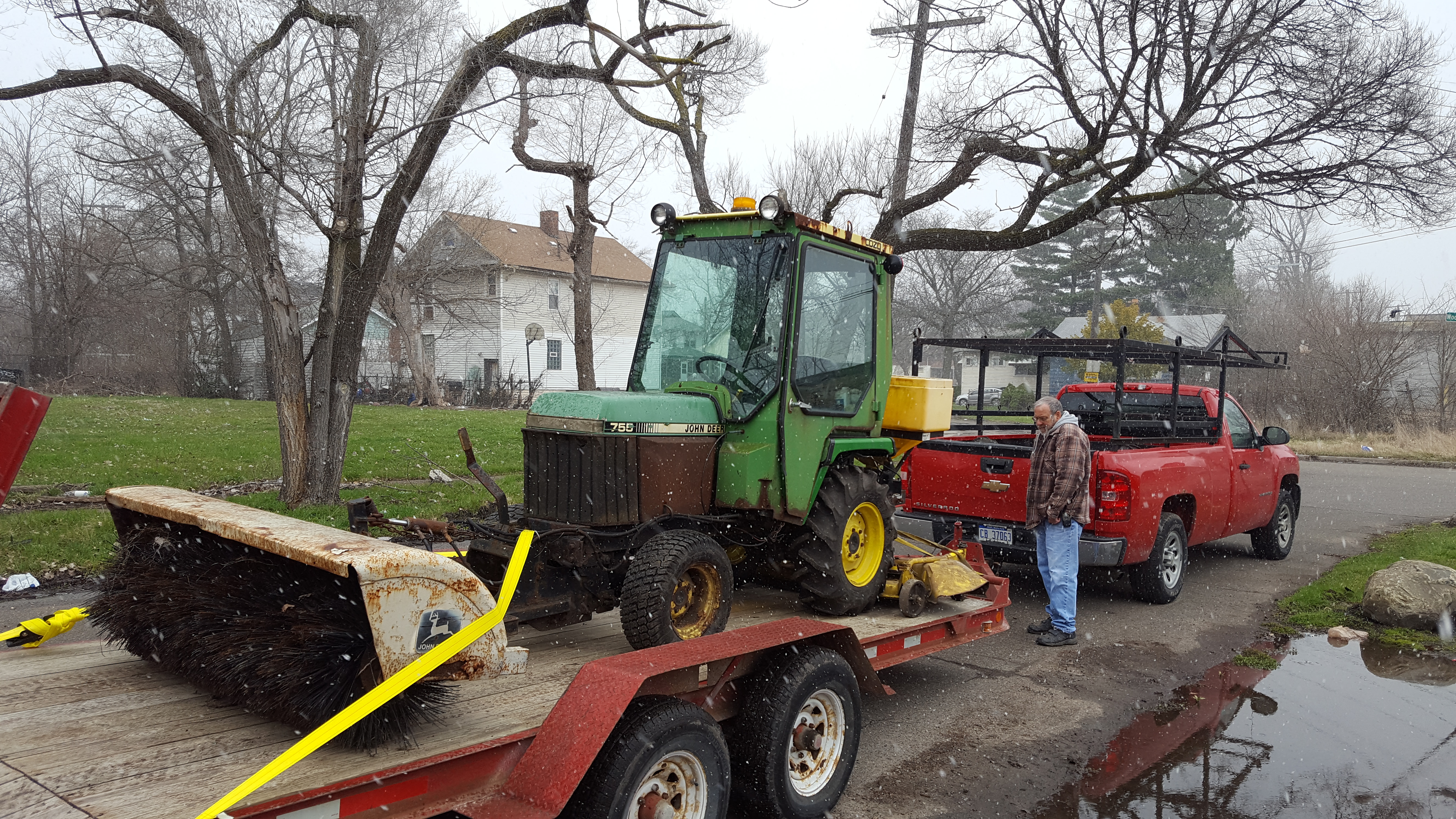

Backhoe and New Carpet 038.JPG I have a 750 and a 755 and they run for hours no problem. Bought the 750 a year ago and bought the 755 this spring. 755 has really low hours but sat outside and all the linkages were rusted up to the point none of them would move. Could not engage the PTO, could not select front, middle or rear PTO, could not change from high, neutral or low range, could not engage 4 wheel drive and could not lock rear differential.JD755-1.jpgGot everything moving and mounted the mid mower deck on it and it cuts great.
