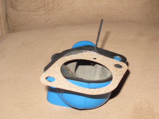

It should be under the upper hose attachment to the head, the housing has a small hole to prevent airlock and should be cleaned out. Note drill bit in photo.
