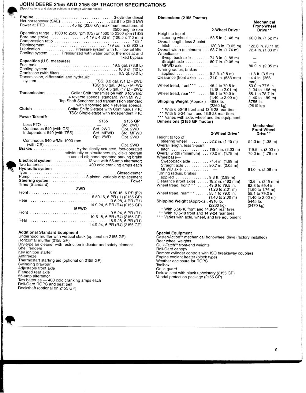

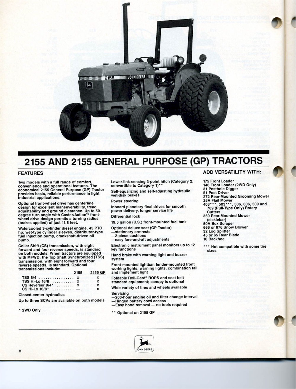

Don't know how your MFWD is engaged, but here are a couple pages of specs you might be interested in.
