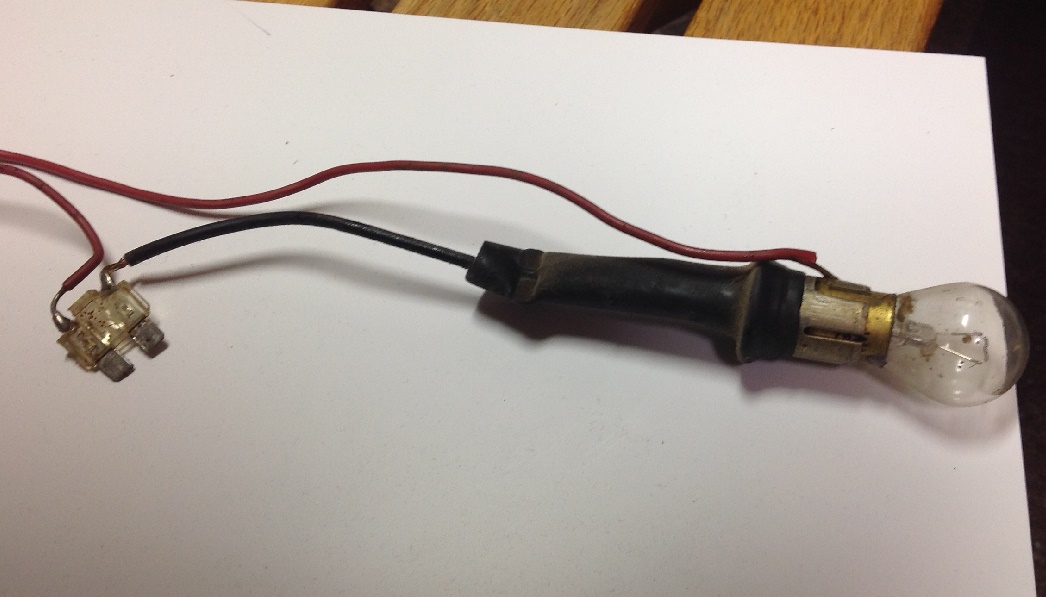

I got a bit lost in the translation but sounds like you are looking for a short somewhere in the wiring.
I make up a "tester" from a 12v bulb and a blown fuse, so it plugs into the fuse socket. If there is a short, that bulb lights up.
Makes it much easier to push and pull and move wires around in hopes to find the one causing the problem. Or lift wires from devices or connectors for that one that causes the bulb to go out. Then the task of where to fix the problem is at least identified.

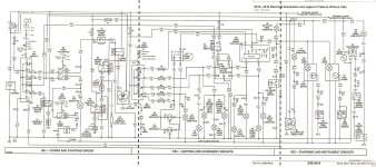

Based on your description, it looks like the wiring for the 5x00 and 5x10 is the same or close, so I have attached the wiring diagram for 5x10. On the 5x10 the third position is dim headlights, tail light(s) and warning lights. These are estimates by me head lights take about 8 amps, warning lights 6 amps and tail light ? Also the instrument lights take a little.
Have you added anything?
Here is what the 5X10 manual, says about the diode -Current also flows through one diode of diode pack to instrument lights. Remaining diode blocks current from passing into high beam circuit-. Does it look like the high beams are on? If you add in high beams you are right up there in amps.
Could be the diode is bad. Have you tired pulling out the diode pack? On the 5X10 it is located under the left cowl, there are little black boxes it is the one closest to the engine. Looking at JD parts (wiring, harness rear), it looks like it is located in the same spot on your tractor. I had a problem on my tractor of the instrument lights not always working, tested each of the diodes in the pack several times and it test good, but it was not until I replaced the diode that I fixed the problem.
John Deere - Parts Catalog

I don't understand the Diode that keeps lights on either hi or low as selected and whether that could be the source of the problem. But there is no ground shown to that circuit.

Thanks, I've looked at that wiring diagram which was posted in another thread.
I had added lights on the loader when I bought the tractor new in 97. I've tested the system with and without the lights wired in and still have the short,
What I noticed in the wiring diagram is where is the light switch circuit which has orange wires for high and low beam.
Also I noticed that the circuit runs through dash lights and may be the source of .92 ohms to ground. I'm heading out to check.
If so what is the load that has melted my light switch and wiring? It is not the lights I added because it does the same plugged or unplugged. The test jumper wire still heats up pretty hot?

I have studied the wiring diagram posted and I do not see the wiring to the light switch.
The head lights are powered with a white, Yellow and black wiring.
Yellow and White wire goes to the Diode block and lights work either plugged or unplugged but only on the low beam circuit. And I disabled the flashing circuit by removing #3 fuse per another discussion thread.
The light switch has a live power input that is burnt but still operates. The wire casing and wire plug protector has been melted.
There are 2 Orange wires on the switch that power the headlights. I believe one may be the high beam

I do not know, why pulling the diode would cause the high beams and high beam indicator not to work. I will need to look at the wiring diagram more.
The orange wires out of the light switch 103 and 113 change colors and numbers after passing through the fuses (do not ask me why). 103 changes to gray 118 and 113 changes white 119
On the fuses, if you pull the 30 amp fuse (F7, 30-Amp: Horn, lights, turn signals) that feeds the light switch I think you will find that is the fuse that is getting hot and NOT the 20 amp. Here is a test to try, pull the 3 - 20 amp fuses for the turn signals, high beam and low beam. Then turn the light switch on if the light switch gets hot it is on the power input side and not the power output side. If the switch does not get hot, put the fuses back in one at a time.
Some meters only go up to 10 amps, so be careful you do not damage your meter.
On the wiring diagram look for fuse F7 near the top of diagram to the left this is the power to the light switch.
   / 1997JD 5300 electrical short in lights #9
My thought is the reason high beam and high beam indicator will not work with the diode pack removed is the switch contacts for high beam have failed. These bad contacts may be creating resistance heating up your wire.
If high beams and high beam indicator works with the diode pack installed, my guess is the diode pack is bad and the low is what is powering the high beam.
I would replace the light switch. If high and low come on together when in low beam position replace the diode pack. I would rewire the added loader lights thru a relay. They may have overloaded the light switch
