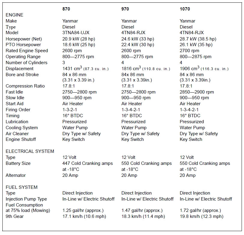

The JD service manuals and advertising only show one engine for the 870.
As mentioned don't believe everything you see and hear. Look at the chart JD755 has posted, note the discrepancy in the two 4cyl engines, same bore and stroke but somehow the right column shows a high cubic inch displacement. :laughing:
