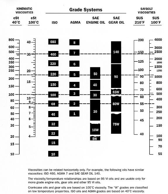

Generally yes. A very VERY common issue raised by new Jinma 200 series owers for example, is "my TPH and steering didn't work this morning. But after the tractor ran for about 15 minutes, everything went back to normal ". In almost every case, this complaint is raised after starting the tractor after the first cold night in the fall. In almost every case, the issue is fixed by the drain/flush/refill with AW32.
The soup the factories put in there is some sickly looking equivalent to 30W engine oil. Yes, UTF is generally multi-vis. But. At 100 degrees Farenheit, its viscosity is still nearly equivalent to that of 30W engine oil ( http://www.castrol.com/liveassets/bp_internet/castrol/castrol_usa/STAGING/local_assets/downloads/0-999/2016.pdf ). AW32 on the other hand is the (single) viscosity equivalent to 10W, and simply doesn't need that "thinning out time" that UTF requires. On the opposite end of the stick, UTF is too thin for the geared creepers/shuttles and trannys and diffs. Again, the Chinese generally ship these things with that awful 30W crap. Their manuals typically specify 40W summer and 30W winter. 80W90 gear oil has a 20W50 engine oil equivalency. As you can see in the chart below, UTF will thin down too much at operating temperature.
But as with everything else, there is the occasional exception; my KM454 power steering for example. Steering gets so hard after 2-3 hours of mowing in the heat of the summer, that I had to simply shut down and wait for the AW32 to cool down. The dealer says it's due to the design of a relief valve internal to the pump itself. When this issue reappeared the 2nd summer, I started experimenting with progressively thicker fluid in the steering system. I eventually resolved the problem with Valvoline 50W racing oil. As soon as I can find a convenient source of ISO220, I'll replace the engine oil.
That said, UTF is the wrong fluid for this job. Too many folks are taken in by the word UNIVERSAL on the label. I think you'll agree, the stuff inside is not actually universal. It's only for applications where the manufacturer specifies the use of UTF.
//greg//
