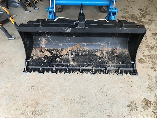

FWIW I have a Piranha style bar on my bucket (homemade plasma project) . I can't think of a reason that I would have switched to a straight edge. What's the purpose of the reversable bar? Anyways, welcome to the group!

Well, their original bolts on the edges of the bucket only. The rest of the bar is held securely by brackets that slide over your existing edge. Here's my version, albeit when it was first done. This was just a fun project for me.
I guess the bolts above the edge wouldn't be a big deal. I just envision the threads would get abused and wouldn't be simple on off deal. They are a great tool for a small tractor, I'll give them that.
