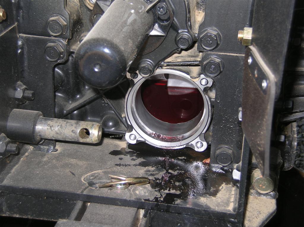

The hardest part for me was removing the original oil filter. I swear that thing was welded on! Just about tore that can right off the filter base before it let loose. However, since that first change it has been a piece of cake getting the filter off.
Make sure you change the transmission filter, and remove the screen and magnets. Look inside the transmission housing after you remove the suction screen/magnets. The transmission on my 2320 was littered with metal shavings. Picture shows a few shavings. Many more were inside. Some stuck to the magnets.
Don't pay attention to the sticker under the hood either. It must be left over from another year tractor.
