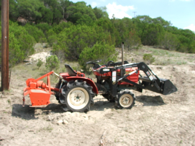

I picked up my new toy on Tuesday of last week and immediately had to go out of town for work so I did not get a chance to test it out until this weekend. Logged a total of about 6 hours total time on Saturday and Sunday. I have included a shot of tilling between the rows of my crop. My neighbor in town said it is the Swiss Army Knife of tractors. Compact, red and does everything. So far so good but I do have a couple of squawks that need some attention. I guess it is 25 years old and I should expect a couple things to not work exactly right. I will address those in another thread and seek some advice.

Upon further thought, is it reasonable to expect a few things to not work right or should everything work as it originally should. Here are the things that I have problems with. 1. Significant leak in the front right wheel seal. 2. Diff lock may not be operational. 3. Fuel shut off valve is stuck in the open position. 4. Brakes have a lot of pedal travel. 5. 3 pt raise and lower valve will not turn. It is rusty.

Yes, I agree that it is important to check everything out before you take delivery. Obviously, I knew about brakes and the rusty valve, and I thought no big deal since those appear to be an easy fix. The inside of the front wheels were completely dry and there was no sign of a leak. I did give it a pretty good work out before I took delivery. I get it on the trailer and drive home to find about a pretty good puddle on the trailer floor. After some use, the leak seems to be getting worse. On the differential lock, I could not really tell until one wheel lost traction while I was operating the tractor.

I guess I should have been more clear in my response. When I was testing the tractor, I had all four wheels getting good traction on level, solid ground so I could not tell if the differential lock worked.
When I was using it for the first time, I high-centered it and had the left wheel off the ground about an inch and spinning. When I stepped on the differential lock lever, the left wheel would continue to turn and the right wheel would not move. I am under the impression that by locking the differential, power is equally distributed to both rear wheels and that was not the case. On other equipment that I own, that is the way the diff lock works. I guess, I will have to figure out what the problem is.

That's the way mine works. One wheel starts spinning, stomp the diff lock and both wheels spin then. Mine is pretty hard to engage, have to stomp pretty hard.
