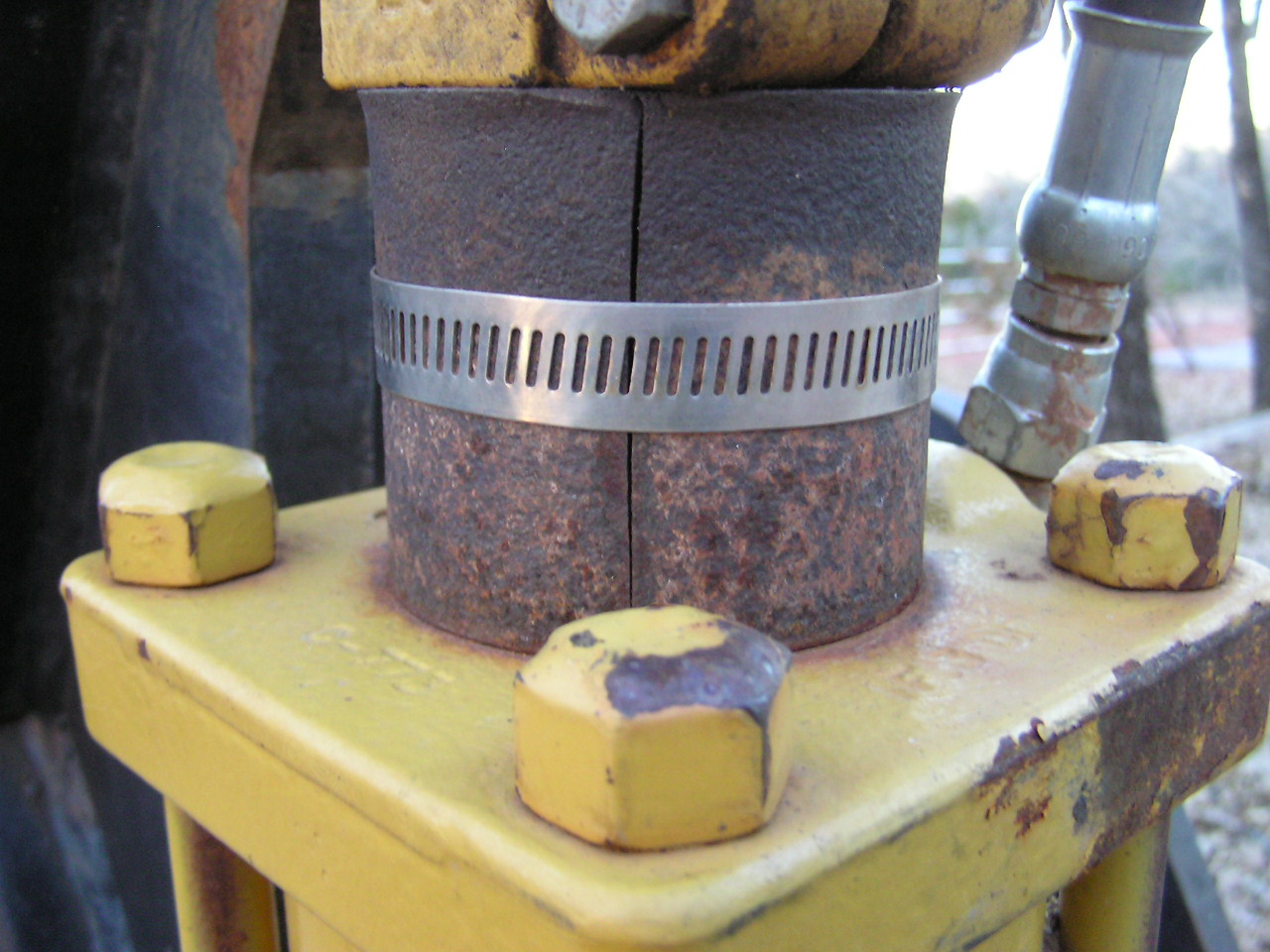

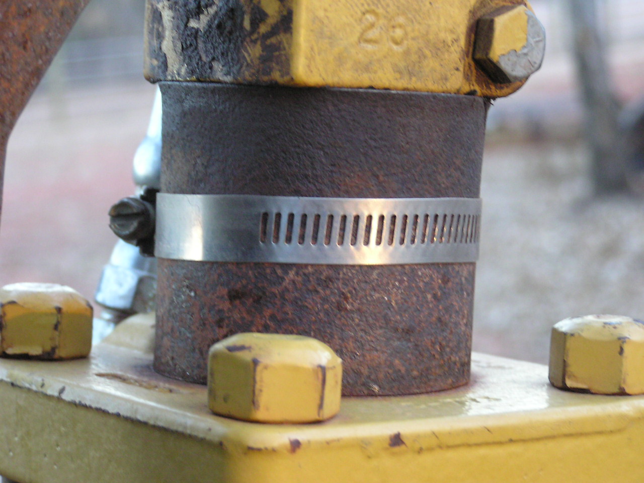

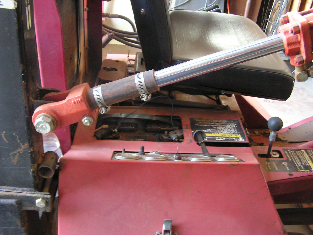

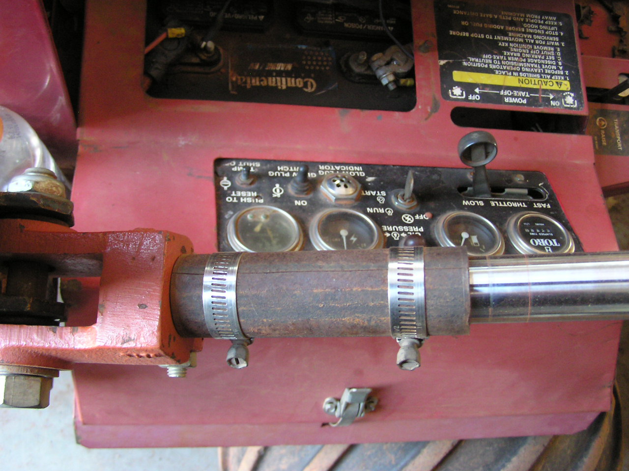

I made some by cutting thick wall tubing that had the same ID as the OD of the cylinder shaft. I cut them to the length that I needed, then cut them in half, long ways, to go around the shaft. They are held together with a hose clamp at each end. They do not slide on the shaft.

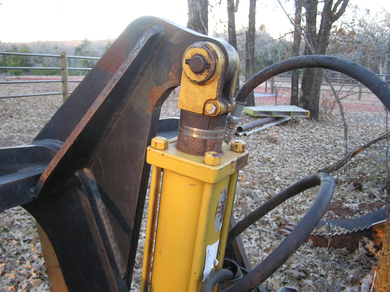

I made this stroke stopper for the Gorilla Grapple, from a piece of 2 7/8" tubing. it has been in use for over six years.
Cut it to the exact length needed, then cut it lengthwise on the bandsaw. This one has a piece of rubber around the shaft, to fill the gap to the larger tubing. One hose clamp holds it to the shaft.
