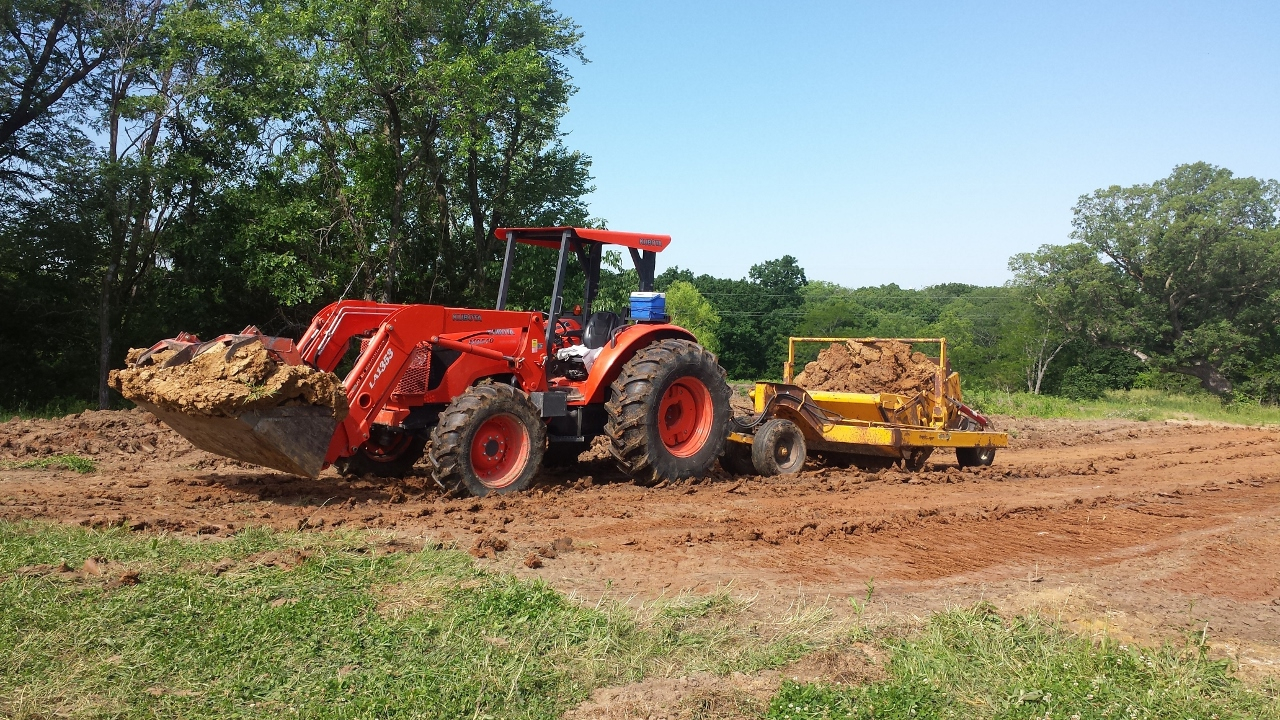

I assume you mean a scraper that hauls the load? I think you could pull a larger scraper than 2-3 cuyd. I pull a 5.5 cuyd clamshell scraper with my M9540. Filling it takes some finesse in dry hard clay but generally handles it.

Filling is the hardest part. In that pic I was scraping virgin clay. I was also hauling 1/4 mile so I wanted to take as much material with me as possible. So I'd fill my loader bucket, which added traction, then fill the scraper.
I bought this scraper for $4,700. It's at least 30 years old. Uses a single hydraulic circuit. I've hauled thousands of cuyds of dirt. When not in use it is parked in a shed. I'll never sell it. Very handy to have when needed.
I only offer my experience with a bigger one to open that potential for you in case you find one for sale.
The guy I bought this one from has tried to buy it back twice. :)
