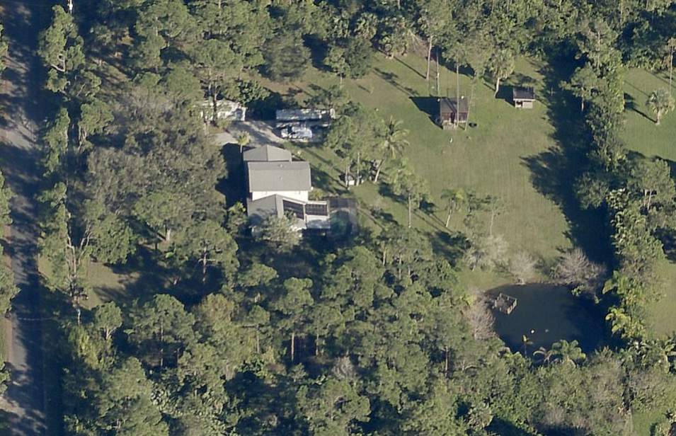

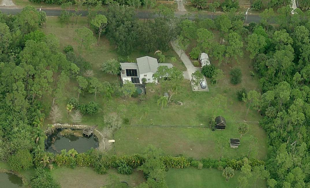

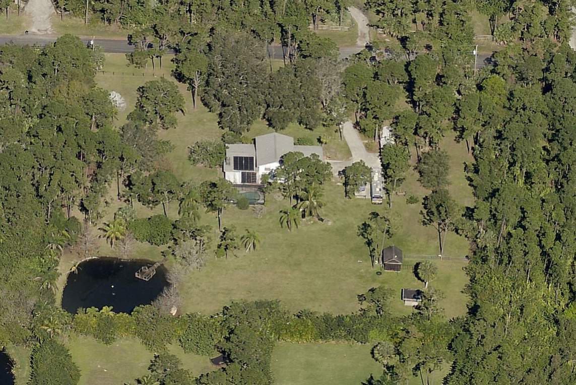

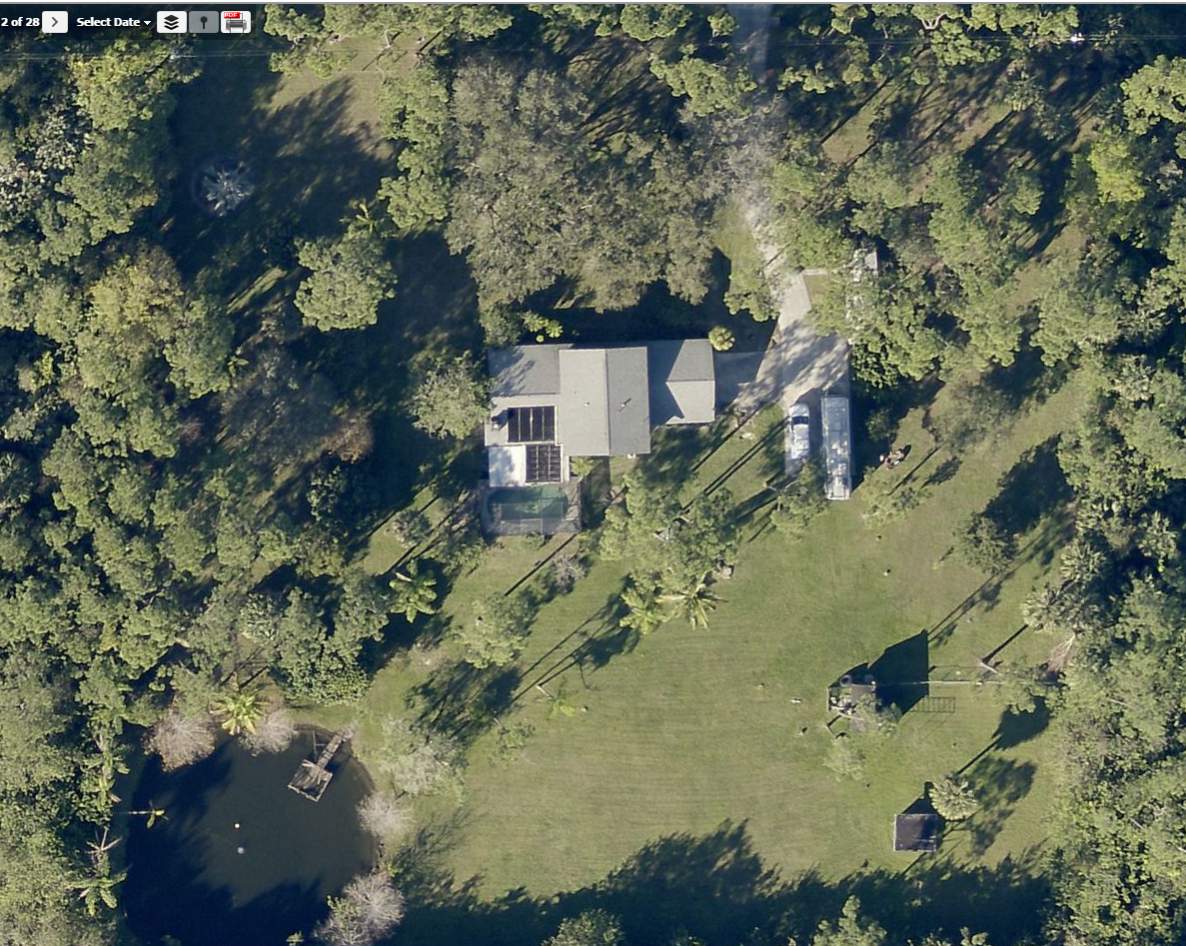

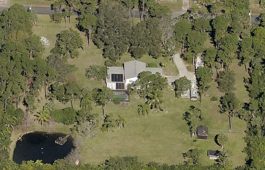

Greetings All,
I just closed on a home on 2.5 acres of land. I've never had a lot this size to maintain before and was curious if folks could help me out figuring which mower/specs would be ideal for my situation:
2.5 acres - really about 2 acres if you take away the pond, house and driveway - Location South Florida
Terrain is not perfectly flat - the house, patio and surrounding area is on a elevated mound (roughly 18-24") above the rest of the yard
Yard has dips, small mounds and a few 4"-8" diameter stumps
There are trees on the property, but would say they are spaced no closer than 10' apart or so
In summer the yard somewhat "floods" during heavy rainstorms (especially in the front yard) and is pretty much unmowable for atleast a 3 days afterwards (evidence of a few mowers getting stuck in the middle of the front yard when buying the house)
Grass on this lot grows extremely fast in the summer (hopefully much slower in the winter) - in just a week it grew 2-3" - Was mowed by landscaper last week

Images below of lot in question:

I am not an expert, but I think that the problem you're going to have is with trimming, especially around that pond. You could spend more time walking around with a string trimmer than the total you've budgeted to maintaining your lawn. Getting close to that pond will be tricky, especially if the ground is damp. You don't want to have to have your equipment hauled out of there! I would not try it with that zero-turn or pulling a rotary mower that wasn't significantly wider than the tractor. The Toro looks like it could get a bit closer since the deck is wider than the tires, but I bet it would still be a bit dicey.
As far as mowers are concerned, I think your choices are to go with a dedicated lawn mower or a compact tractor.
If you go with a dedicated mower, then I think that Toro you link is perfect. It's meant to mow a lot of grass fast. I wouldn't consider anything smaller than a 72" deck for that yard.
If you go with a tractor, get one with a mid-PTO and a belly mower. If you get a subcompact tractor with mid-PTO, then down the road (when your significant other gets over the sting of this purchase), you could consider a small PTO-driven mower with a big offset for the 3PH to allow you to mow around the pond without risking an impromptu bath.
I'm not sure what's available for your budget, but some of the folks on here could probably help.
